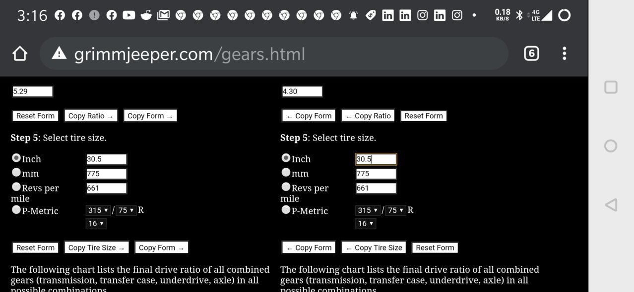

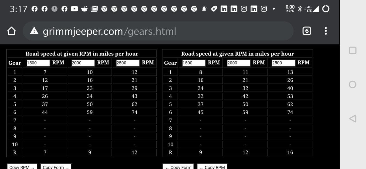

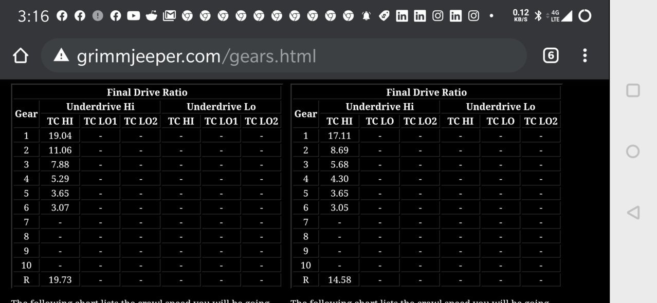

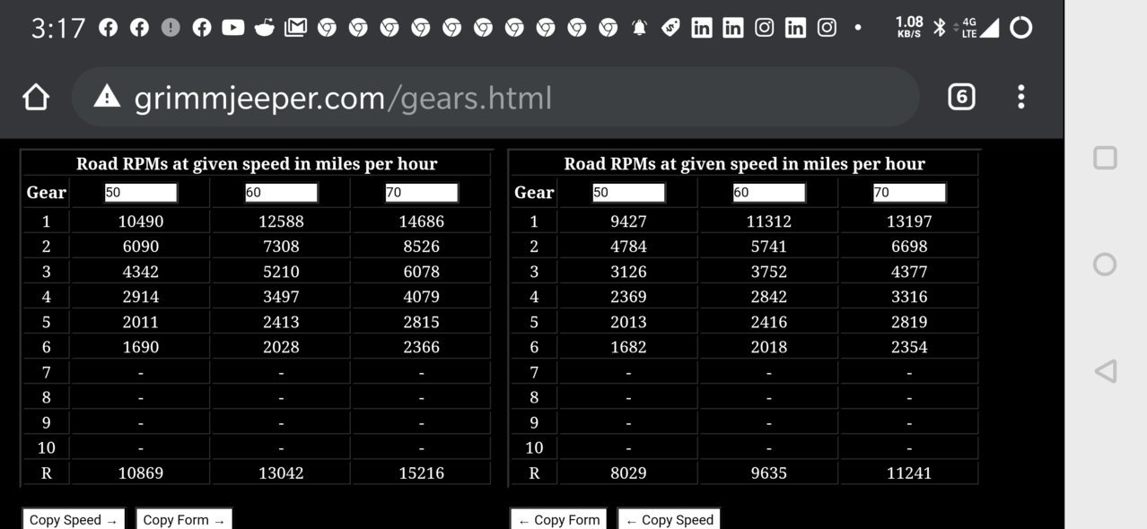

    I'm confused why 5.29's would be considered too much for a factory tire. I've run the numbers in comparison of a 6speed auto with 4.30 gears vs. a 6 speed manual with 4.30 gears, and the final drive and rpm @ any mph from 4th gear and up are almost identical. So if 5.29's are too much for a factory tire would it be safe to say the 6 speed auto is undergeared and the 6 speed manual overgeared from the factory?

    I understand. I guess the real contemplation I have is the rpm's my motor will have on it with 5.29 gears. I was concerned, having a 2.7. Then I saw the factory specs for a 5speed 2.7 running @2800rpm in 5th gear @80mph from the factory, which is a higher rpm than any 3rd gen Tacoma application. Switching over to the comparison of 5.29's in a 6sp auto vs the 6sp MT being comparable, I have to wonder why 5.29 would be too much for a 2.7L.

    There is no way the final ratio of 5th and 6th can work out to be the same between a 5.29 and a 4.30 without a gearing change in the transmission to compensate.
    If your grimmjeeper calcs are assuming the only change is the axle ratio, their last two calcs are wrong on the 5.29 side.

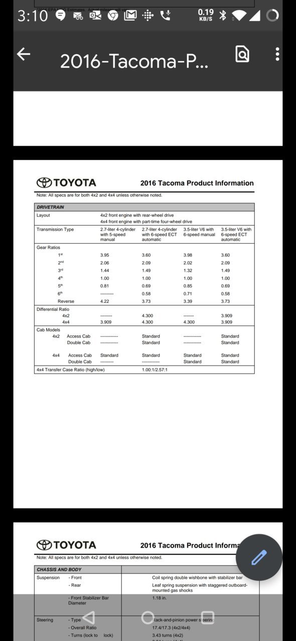

    I believe it is because the gearing in the transmission is different. Look at the specifications of the gearing between the two in the chart above and then see after I inputted those numbers into the calculator the final drive and the rpm@mph from 4th-6th work out to be almost the same. That's my conundrum.

    It seems that the majority of the transmission issues, being undergeared and not utilizing both overdrives correctly comes from the 6sp AT. This is the same transmission I have. 6sp AT are the same for 2.7 and 3.5, so the transmission gearing is the same. The only difference is the pinion gear. I'm just curious if the 5.29 was too much, then why would Toyota release two applications; (2.7L 5sp MT, and the 3.5L 6sp MT to run at a higher or equal rpm than either a 3.5 or 2.7 AT with 5.29 gears?
