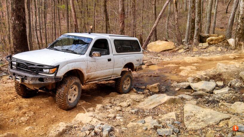

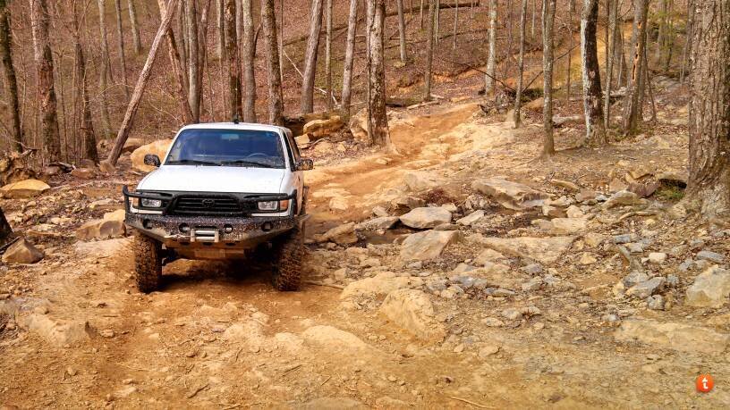

    King Extended travel coilovers, 5100 Shocks, Daystar shackles,OME Leaf Springs,255/85/16, front diff drop, RAT skid plates, 4.56 gears, LSD in rear, Aussie locker in the front, Front Range Offroad twin sticks, trail gear/ Bash Fab rear bumper, elite off road front bumper and sliders, warn m8000 winch, in cab winch control
    here are my 255/85's

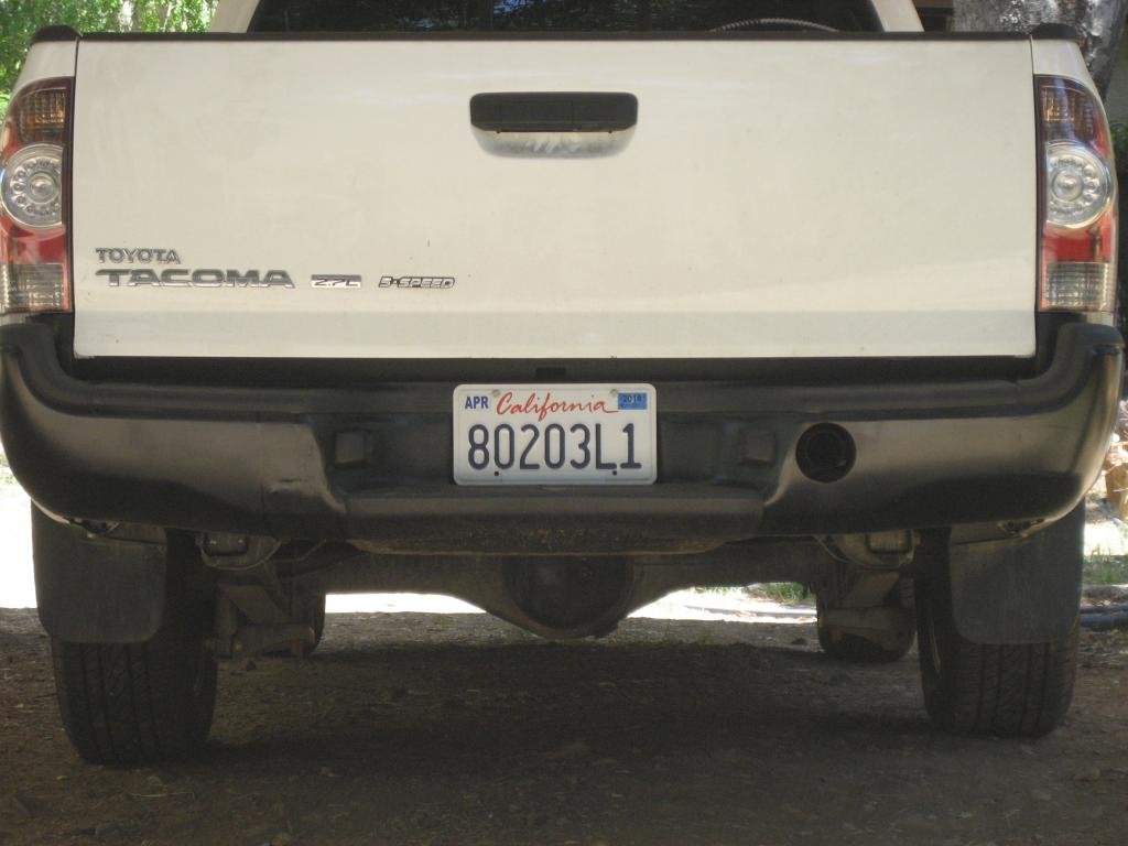

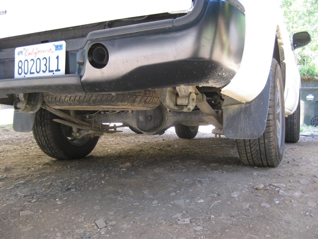

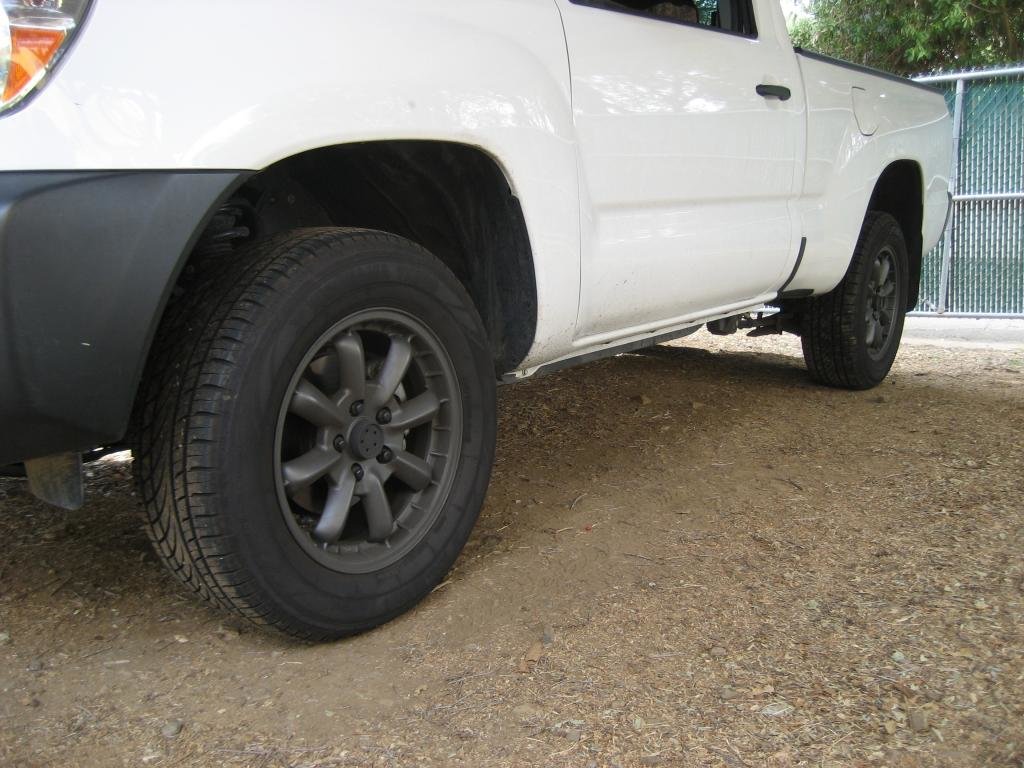

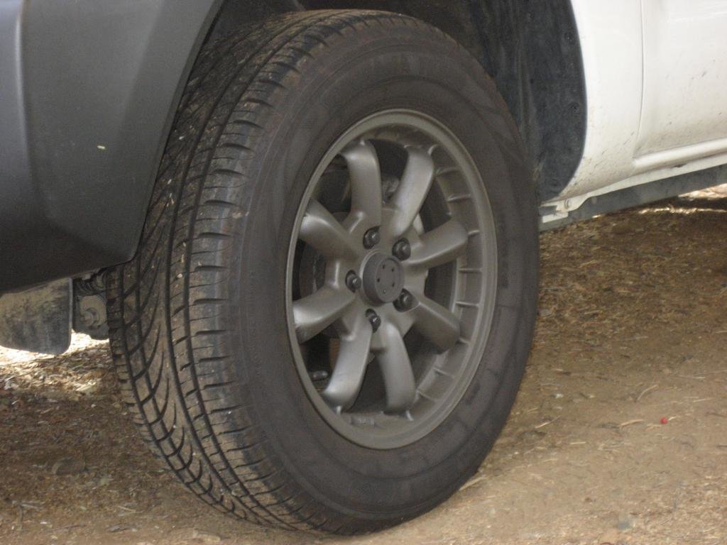

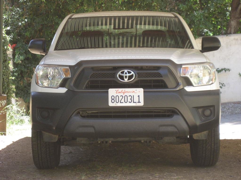

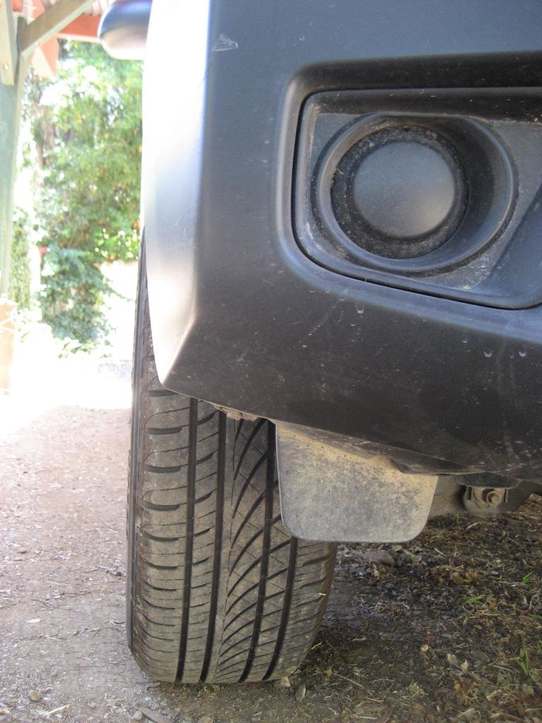

    I combined larger lighter wider 16x7 alloy wheels with wider lower aspect ratio 235/60 tires on my 2.7 5 lug street Taco... and the truck rides really smooth and corners great. :)
    This combination is nice and wide, but yet it's within one percent of the stock wheel diameter so the speedometer and odometer retain their factory accuracy.

    Can you please take a front view picture? And thanks for the input!

    Sure. :) I'll take one tomorrow. Even though the wheels are wider than stock, they're +35 offset so they tuck nicely inside the stock fenders without needing to add flares. I didn't go crazy with really big wheels and super low aspect tires, because when you go below 60 you can't get any long lasting, high mileage, low rolling resistance tires. I'm running Yokohama YK 580 tires. 580 is the tread wear number which is relatively high with a 60,000 mile warranty.
    This setup is different from most all of the other Tacos because mine is a street driven work truck that never sees dirt.

    Here's the pics. :)
    The tires are nice and wide without increasing the overall wheel diameter. This keeps the centers of the wheels relatively close to the ground for good handling in the corners.
    As you can see in the last photo, the edge of the tire lines up perfectly with the outer edge of the wheel well.
