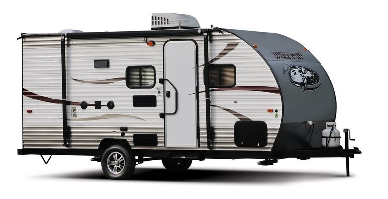

    All season mats, 2nd filter delete, DT header, Jardine cat-back, URD shifter, Bilstein 5100's all around at .85 front with Eibachs + .25 passenger/.5 drivers spacers and 1.5 AAL, 0w20 synthetic, Scanguage II, extra D rings, OEM backup camera+Mirror, bed mat, Extang Solid Fold, Popnlock 5300, Pro Comp 7089's 4.5bs 285/70/17 Revo 2s, De-badged
    Towed this with mine 10 times this summer. Its not fun but it does the job fine
