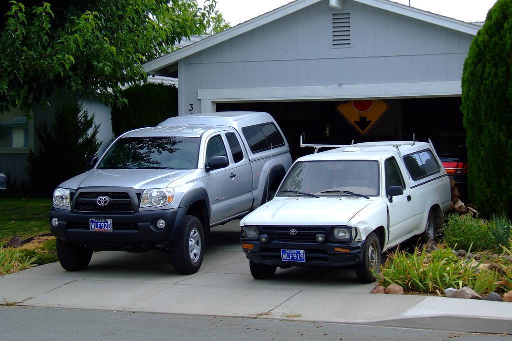

    '11 Tacoma 4x4 AC is my 4th 4banger manual Toyota PU
    1. Yes! Cruise control maintians speed on most hills. Some hills I have to downshift for. CC works better with manual than auto from what I've heard
    2. 20 with winter gas 24 with summer gas
    3. Only if I towed stuff. My 4banger can go any where the V6s go. I use my PreTaco to haul firewood (1/2 cord at a time)
    My Toys '11 & '95
