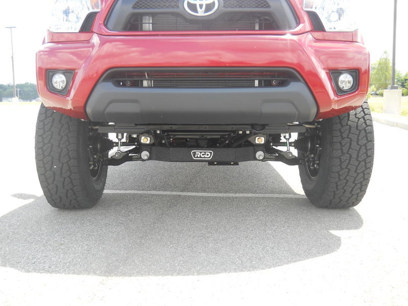

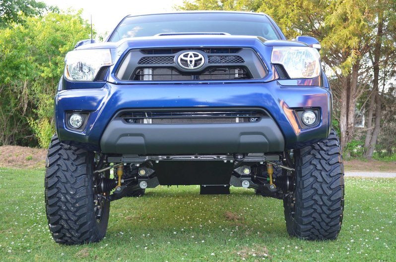

    If high RCD type crossmembers, then you are complaining of lack of the ground clearance.:wink:
    4" Rough Country looks better than 6":
    6":[​IMG]
    I don't understand why people thinks that any suspension lift increases the possible tire size. It's not true, let's take an example, expensive e.g. Icon stage 3 mentioned before, it's not increase tire space at all! If it would, the bump stops would be taller for limiting the uptravel to prevent tire touching to the inner fender.
    Rough Country is not a great just out of box, but the basic things are ok, beefy crossmembers and spindles. You can upgrade it by good coilovers/shocks, RC's own shocks sucks.
