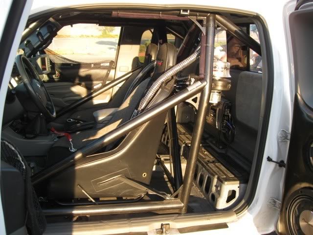

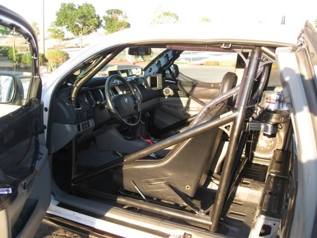

    Well then post pics, man! Let's see what you've got!
    My pile:
    You've got stereo stuff listed in your mods but no mention of a cage?? Pics!!

    oh i havent put it in yet, im kinda savin it to make sure i have room to do some other stuff to the interior so i can have room to move around.. yours is knarly though man, who did the work?

    Carroll's Rod & Racecraft here in NJ. (http://www.rodandracecraft.com)
    It's all 2" .120 wall chromoly and is SCORE tagged.
    Whoever you have do your rollcage will know exactly what's needed for the harnesses as they have to tie into the cage design. It's potentially your life on the line so go with someone who knows their stuff. :thumbsup:
