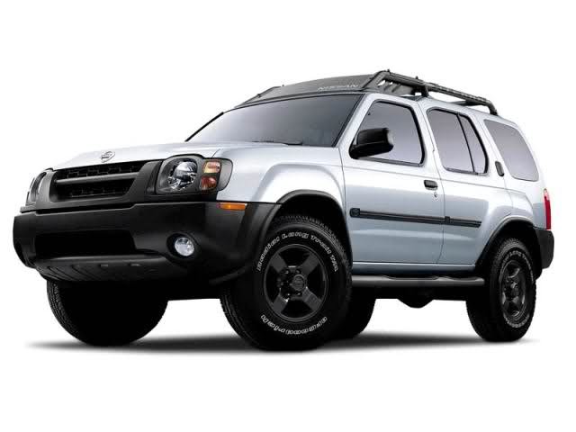

    i really like this Nissan wheel but bolt pattern won't work.
    anything else out there with 4 spokes that'll fit?
    6x5.5" bolt pattern.
    thanks.

    so 00-04 (not 05+) xterra do share the bolt pattern and hub bore, and they do have x style wheels.
    only bummer is they are 16", not 17" like the later models but whatever.

    You're in the minority because those four spoke wheels are butt ass ugly.

    subjective statement, at best.
    naturally, one would ask if you have seen them on a silver tacoma? and in gunmetal?
    probably not, but like i said, it's subjective, therefore completely moot.

    Obviously opinions are subjective. You thinking they look good is subjective. No difference. I happen to be on the side that they're ugly(as were the old school ones shown above). I briefly looked at Xterra's before I got the Tacoma. One with those wheels was not an option.

    thanks. i'll talk to the shop i'll use to see if they run into any issues with such a thing. i can figure aftermarket wheels are universal in such a manner, and adapters might need to be used in some cases, but make to make is a weird situation. apparently there are many people who run one brand wheel on the other vehicle, but i've not seen anything about TPMS. like you said maybe it's a non-issue and that is why i haven't seen a thing.

    the TPMS should fit. its just a small oval puck that goes in the inside of the wheel.
    i don't know of too many people putting nissan wheels on a toyota, it's a little blasphemous, but whatever! ( i really shouldn't talk, i have mazda wheels lol) lol if you like it go for it. those rims aren't too flashy or anything so it should look fine. make sure they fit though first, not too sure on bore sizes on the 6 lug trucks and/or the nissans.

    thanks. it'll be interesting if i can't figure out a center cap solution ; )
    haha, i recognize those rx-8 wheels! they were/are popular for use on the mazdaspeed3.
    the older nissans, at least 00-04, have the 108mm bore. the new ones have the rinky dink bore size...i can't recall but it's SO small.

    lol for sure, if anything you prob could grind off the logo or something. or run no centercaps lol
    yah the newer nissans have a super small bore size, alot of the guys down here run titan rims on their hardbodies and colorados, i know for sure the colorado guys have to bore em out.
