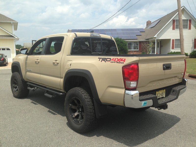

    BDS 4in suspension lift 305/ 60 R/18 tires fuel Beast rims
    I have owned 10 tacomas I have tried different lifts and when u change the geometry on the shafts u put series stress on all parts. the suspension when on hard road surfaces
    can cause the tires to leave the ground very violently especially when hitting uneven surfaces in the road.
    I really do not care what lift anyone uses/just be aware u get what u pay for...
    GOOD Luck

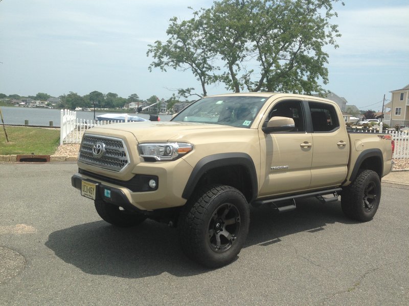

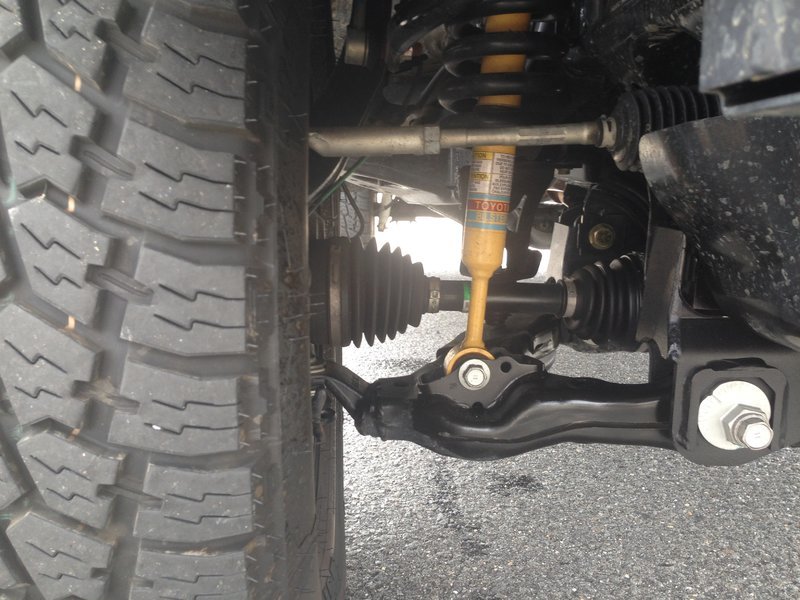

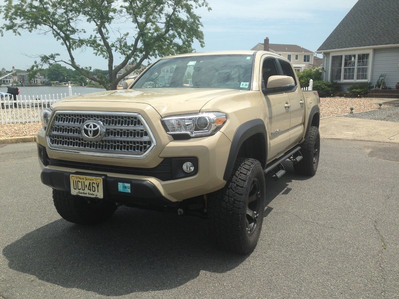

  4. Jul 7, 2016 at 1:16 PM
    #24
    rich1761
    rich1761 Member
    Apr 28, 2016
    #185573
    9
    Richard
    2016 tacoma off road TRD
    here is some pics
