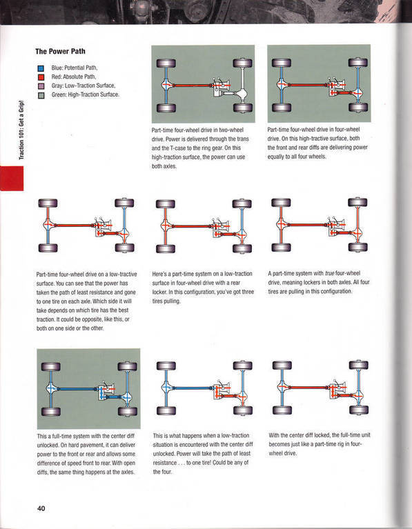

    one last question for tonight. i was under the impression that lockers and lsd was the same thing so i was asking everything about locking diffs. is it possible to put in some kind of lsd in the rear instead of lockers?

    186000mps
    186000mps ..Slingin' up mud and we're scarying off bunnies..
    Aug 29, 2011
    #62581
    786
    Charles
    Wimberley, TX
    01 Tacoma V6 4WD
    Bilstein 5100's, Toytec front adjustable coilover kit, Exporear leafs, Fox resi rears, Slotted & Drilled front rotors, 33x12.50 BFG ATs on Outlaw II 15 x 10s, Bushwacker cutout flares, K&N cold air intake with aluminum sheathing water baffles, ARB bumper with XD9000 winch with wireless remote, IPF 900XS lights, Flowmaster cat-back exhaust, Rhino bed liner, UWS gullwing toolbox with tools and recovery gear. 48" Hi-Lift Jack secured under toolbox.
    OP
    This book answers 95% of your questions. It's Jim Allen's Four-Wheeler's Bible.
    It explains how the diff works, recovery gear and a whole lot more.
    Good open diff explanation
    bouldergti likes this.
