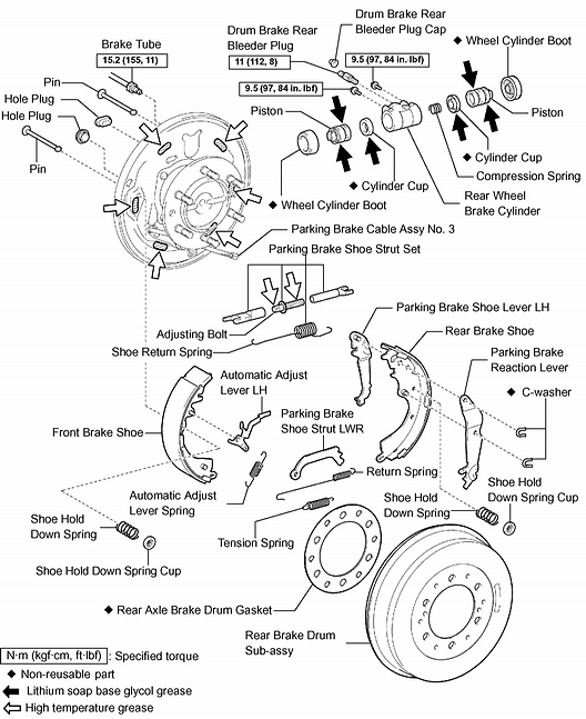

    I was hoping you were done with the rears and didn't have to get back in there again.
    Good diagram. Useful!
