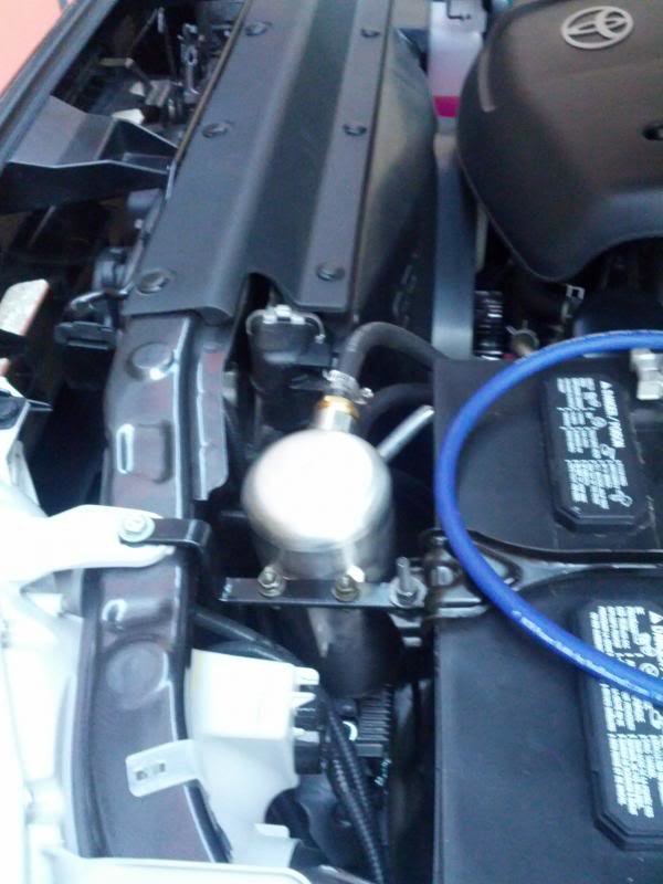

    i've got my truck in the shop for suspension work and they're going to fab a mount to install my can in the space between the battery and grill. will put up pics when i get the truck back.

    bracket made by torfab in Mukilteo, WA

    That looks good man.

    I like that /\

    Me too. I just picked mine up Thursday and have been trying to decide how to mount it and where. I think I like that spot better. That way I won't have to relocate it when I tub the firewall and fenders. Although I may have to remount it since I will have to relocate the battery to the bed when I do the fenders.
