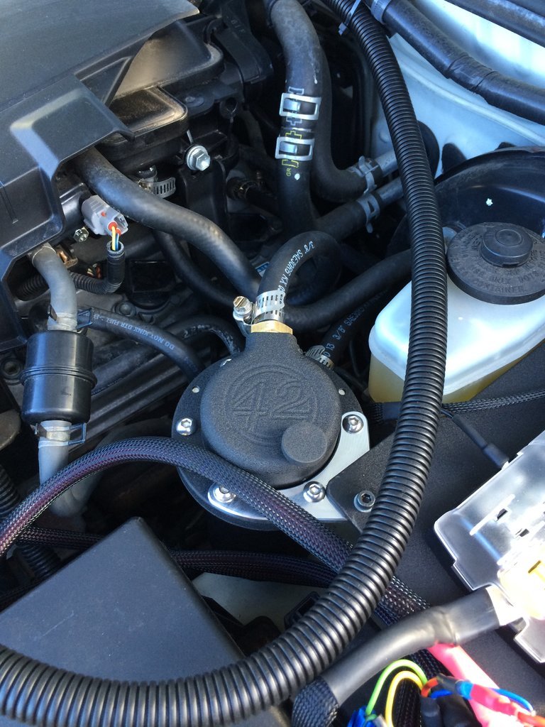

    forgot to post mine, 42 DD oil catch can finally found a home

    Im stealing that idea! I have a fuse block there and wasnt sure how I was gonna mount it.

    Fake, that engine bay is too clean. Obviously photoshopped :D

    I drilled that hole to use as a mounting support, but my panel didn't seem to need it even with the vibrations.
    it was a little tricky getting it to fit with the fuel line routing at the bottom though, might need minor adjusting.
    :rofl:
    thanks! spent a couple hours looking around to where I could put it without drilling any new holes into the body.

    Mine already came with a cross brace, but whats one more hole... lol I have extras anyways because of different fuse blocks.
