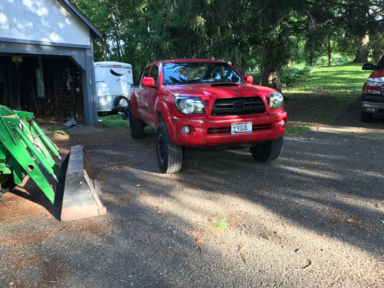

    Rear Wheeler's progressive AAL Installed(w/TSB No Overload)(2017):

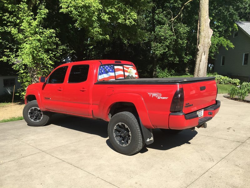

    American Flag/Eagle Rear window because I am a proud Eagle Scout(2017)

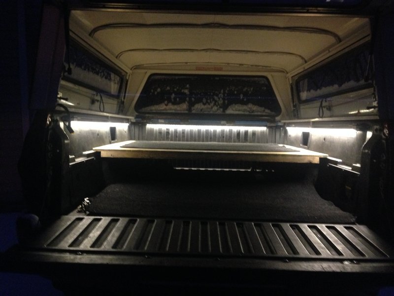

    MattGecko's awesome bedlights(2016)

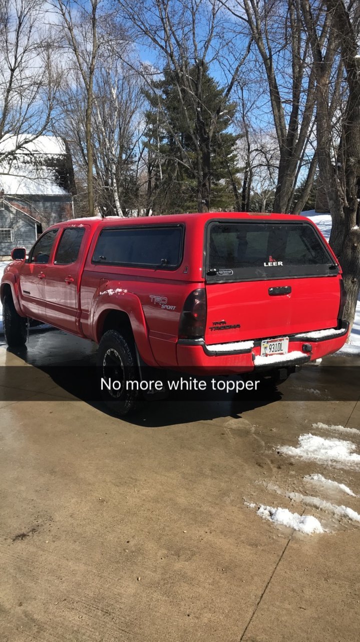

    Leer 100R (2018)

    2. Got the bedlights installed. Ordered from mattgecko. They were a great addition during the ski season as I practice at night often. Can't wait to use them at summer music festivals as well. UPDATE: After one Minnesota winter the connections were corroded and actually fell off for the RF switch. I knew I should've used heat shrink over crimping. Add that to the list of things to list
    3. Dropped the back window tint and replaced with a slightly obnoxious symbol of America. But hey, it matches my license plate and I love the red white and blue!

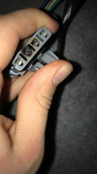

    4. Fan stopped working on all but high. Connector to the resistor was super burnt as you can see in picture. Installed a new resistor and replaced the connector. $30 from O'Reilly Autoparts.

    While the old gemtop was great, it was not a perfect fit, nor was it a perfect color. Picked up a used Leer 100R and had it painted 3L5 radiant red for a grand total of $750. Having windoors on my gemtop made me realize I could never go back. Searched around on craigslist for about 4 months before a long bed fiberglass with windoors came around. Needless to say, paint matched very well. I've got plans to add a screen to the front cab window and insulate/carpet the topper this summer.
