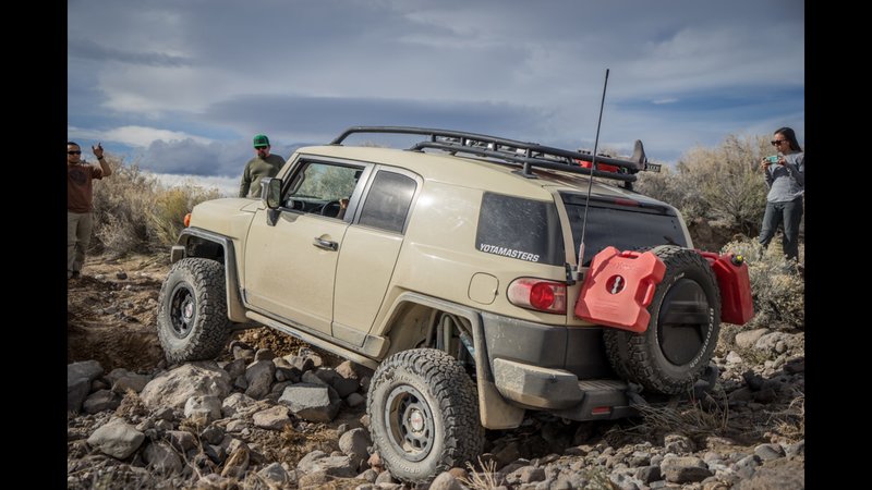

    You belong in a Toyota commercial. Holy Hell! is that Tyler Pelfrey's Truck?

    I should subscribe to my own build thread lol.
    Yeah that's Tyler with us on the JT run
