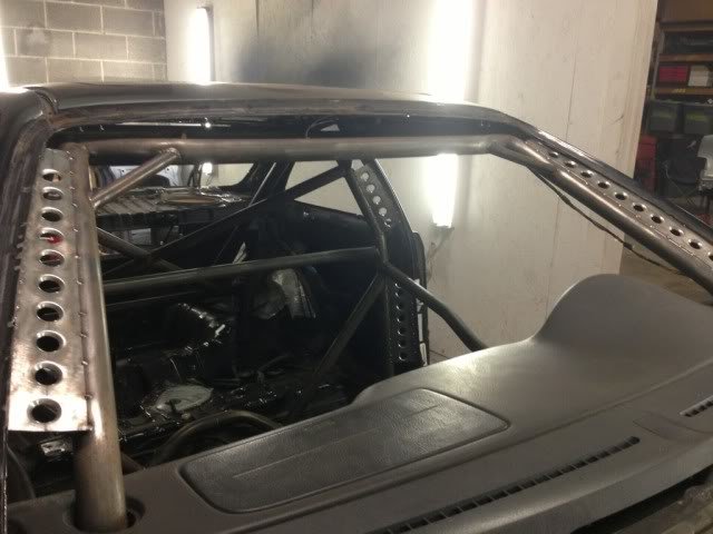

    Got the windshield bracing roughed in this morning...

    Looks good! Are you tying those into the stock dashbar or a new one?

    Since the cage is so close to the skin of the truck and some cut edges of body panels, do you think you'll have any amounts of nails on chalkboard-like screeching sounds caused from driving vibrations on or off road?
    Such as in places like this area

    I have a section of 2" DOM running behind the cowling to the A pillars. What I'll probably do is cut the stock dash bar to fit and weld it to the cage.
    Only pic I have right now that kinda shows it. I like that the bracing is tucked close to the windshield area.
    I don't think it'll be moving around at all. The cab will be welded to the cage in all over the place (mainly along the main pillars) with some dimple die sheet/plate kinda like this -
