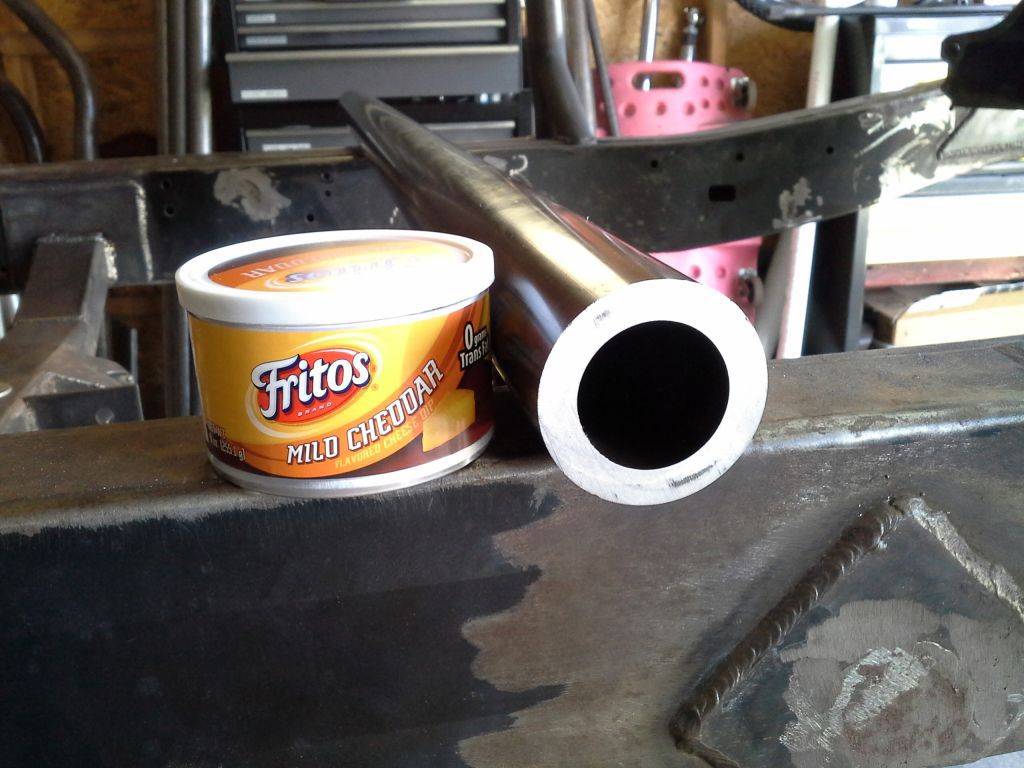

    FINALLY picked up the link material for the rear axle. HOLY BALLS these lower links are gonna be huge. :eek:
    2.25" OD x .375" DOM ~ 40lbs each.

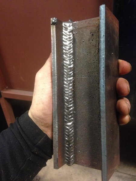

    Hey someone needs to seriously teach you how to weld uphill. Downhill weld will get nowhere near the penetration as an uphill weld. Other than that your improving by a lot

    Vertical welds should look like this
