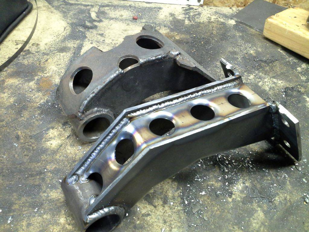

    New vs old motor mount :cool:

    [QUOT E=45acp;8508103]New vs old motor mount :cool:
    [​IMG][/QUOTE]
    Purdy

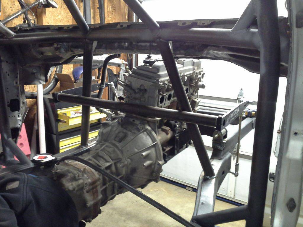

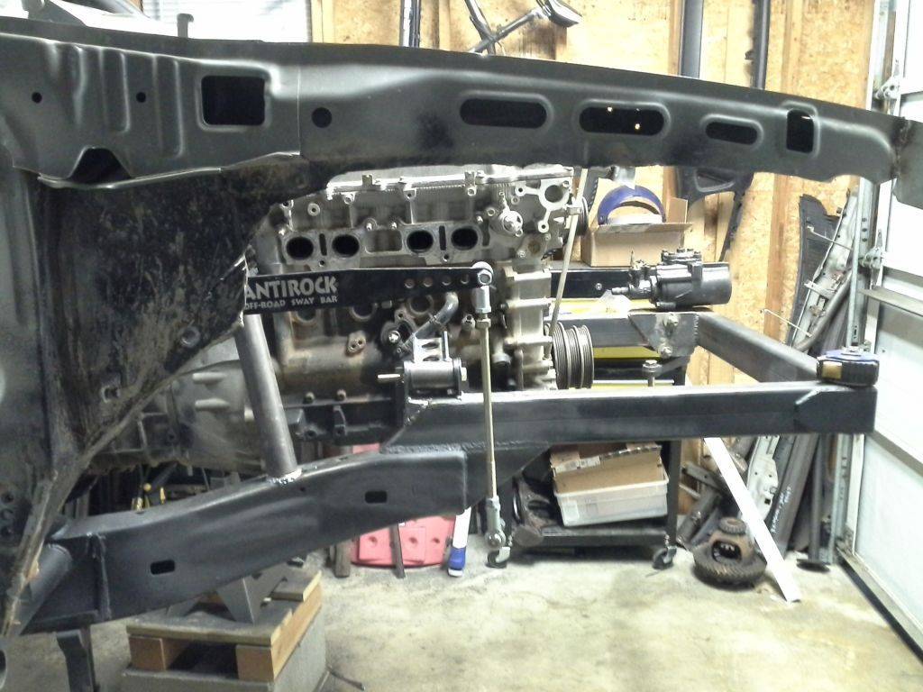

    Thanks guys. :cool: I'm actually getting some crap done today. Finished the motor mounts, finished fitting the cab and permanently welded it on, and started mocking up the sway bar since it plays a role in getting the firewall figured out. The 18" arms are gonna be used on the rear axle, and I'll probably get the bent 20"s for the front.

    Race truck sway bars :cool: aaaand nice weld/dimple porn!

    The sway bars are able to disconnect right? or how do they work to allow super flex yet stable road? just curious....as i might want to know for my future rear setup :D

    Yeah the heims have a stud that are just bolted there. Zip tie them out of the way I suppose

    Where is the sway bar going to connect to? I'd say roll the axle under there and figure out a lower place to mount it. I don't see any advantage to it being up that high.

    It'll connect directly to the axle. It's there out of necessity more than anything.
    Mounted under the front - steering and panhard in the way
    Mounted above/in front of engine - panhard bracket is in the way
    Mounted below/behind engine - tranny and/or oil pan and upper link in the way
    Mounted above/behind engine - clears everything :thumbsup:
    I don't think the placement height has any effect on it, the only suggestion/rule is that the arms are parallel to the ground at ride height.
    eta - here's an example where the arms are really high

    Your welds are definitely improving by a lot. Looking good bud

    god took me forever to find those damn arms..haha WAY up there! haha

    Thanks man, I think I have adjusting the settings down pretty good, but technique and consistency still have a ways to go haha
    Yeah, I'm curious as to what is used for the sway bar links at that length.

    Probably heims don't you think?

    Miniature heims is what all anti-rock's use.
