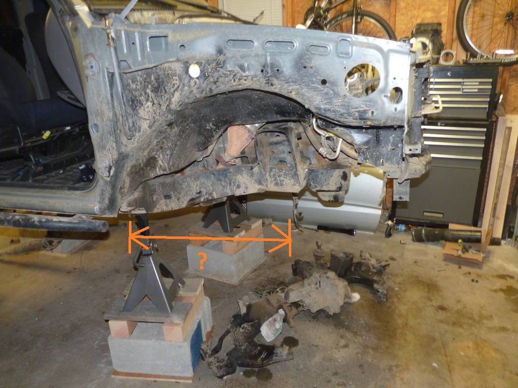

    Anyone care to get this measurement for me? Pretty please?:eek:
    Center of the body mount to the CV axle shaft

    Mine was 22.5" or so. The Dana 60 is right around 24.5" from the body mount, if that matters.

    No, that's good to know. Helps me get an idea as to where mine is at or should be at.
    The outlines of the body mounts are the only remaining reference points on the frame. Literally every single tab/bracket/mount was cut off. :eek:

    Dayum... I tossed the D60 in place the other day to get it ready for shocks and it's sitting at 27.5" from the body mount. I'm sure there's some adjusting to do, but not a lot room to accommodate 'drastic' wheelbase changes unless I chop and move the panhard mount.
    It doesn't really seem ridiculously far forward to me. :notsure: Unless the 40s filling up the fender area are making it look that way? Haha

    Remember, the axle moves forward when flexed so you don't have to go super far forward with it. Depends what you're trying to achieve.
