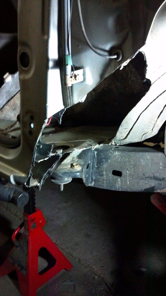

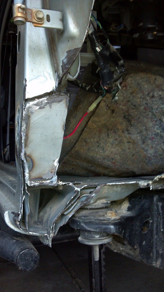

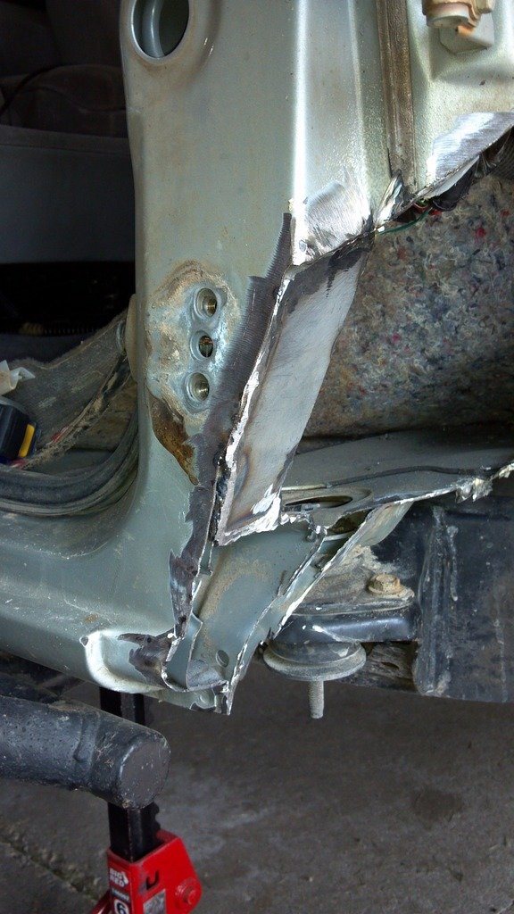

    It's slow going, but going pretty good so far. I probably cut out a lot more than I really needed to for 35"s but I wanted to be SURE they would clear, I don't want to go back and do it again later. Especially if I go larger and eventually SAS.

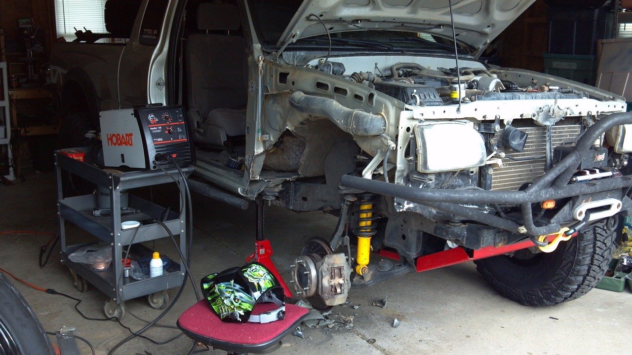

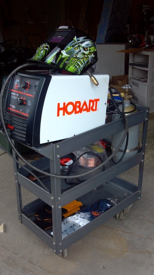

    I picked up a nice Hobart (XVS?) auto darkening helmet at the local farm & fleet. Was marked down from $148 to $88 because the package had been opened. Works great though!
    I cut a rather large section out near the door hinge so I cut a piece of 1/8" to fill the gap and reinforce it.
    I'll be going over it again and the rest of it will be 22ga sheet.
    The Hobart works great though, I'm quite happy with it. The welds were a little messy at first, but wasn't too bad for my first time I guess.:eek:

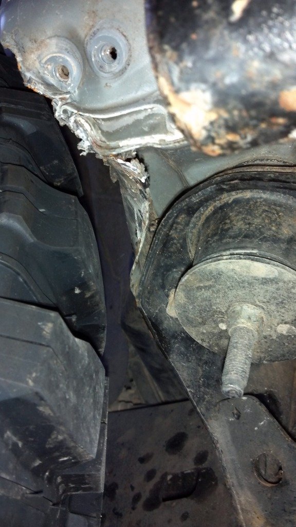

    On another note, the body mount is awful close, so I think I'm going to do a chop similar to the 2nd gens.

    Take your coilover off and cycle the suspension that will tell you if you need to take more out or get into the body mount at all.

    i don't think you will have to do that. Just slap the tire back on and flex it out to check. All the write ups i have seen don't do that.

    Taking the suspension off would be a huge PITA, especially with the added 1/4" spacer. I think what I'll do is since these can be done separately, I'll tub the firewall and find a place to flex the suspension. If it rubs the body mount, then I'll chop it.

    I also think I'd be a good idea to remove the front struts in order to check FULL stuff... :notsure:

    Looks like you have cut out more then enough, but easiest thing to do is just pull your strut out and cycle that shit.
