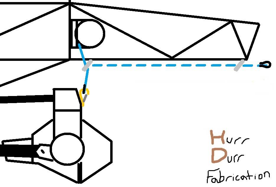

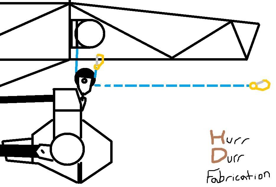

    Is there any reason this setup wouldn't work to act as both a suck down winch and for recovery? Simply add a snatch block to the axle and a place on the chassis to hook the winch line to. Just unhook to use for recovery.

    It would mean it would suck your ass down every time you used it to recover. I dont like it.

    ^ agreed, the winch would suck the suspension down to bump before it started to TRY and pull you towards whatever the line is attached to.

    Could you unclip the snatch block on the axle and run it thru some sort of large fairlead? (I have seen tubing used as a fairlead for synthetic winch line)

    Why use a block, just mount the winch in a way the line has a clear shoot to the axle and for a pull. Or if a block is needed mount it on the frame/tubing so it won't pull the axle.

    The block is supposed to be intended to simplify things so you wouldn't have to take anything apart and run them through fairleads. I figured it would suck the back end down, but didn't think it would be much of an issue.
    This was my original plan. 2 hawse mounted at an angle, a hook welded to the axle, and a thimble end on the rope. Unhook for the axle and run it through the 2nd hawse.
