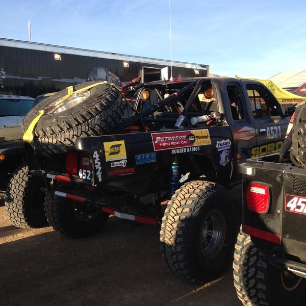

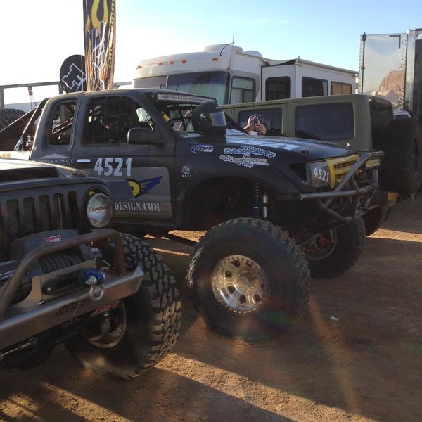

    Thought of you when I was at KOH during the EMC race :D Sky Offroad race Tacoma, actually did pretty good but didn't finish lap 2 so they DNF'd.

    Fuck yeah!! Awesome haha :D That's the first Tacoma I've seen running KOH. I looked at the roster last year and the older pickups were the closest thing. :jellydance:

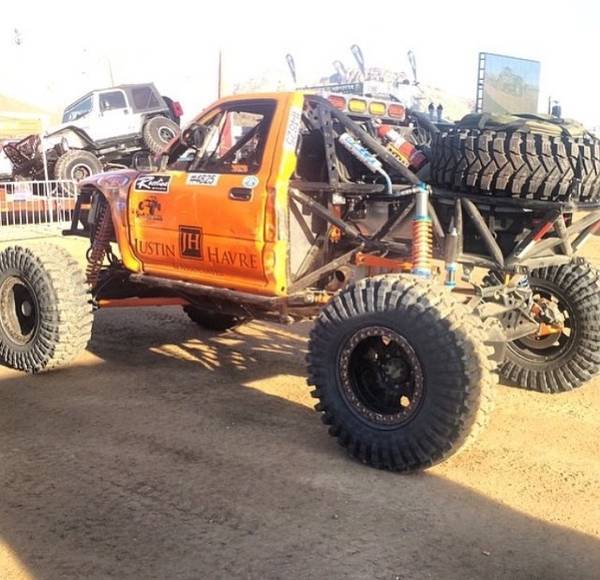

    Saw this on insta

    Was reading that build on pirate the other day.
