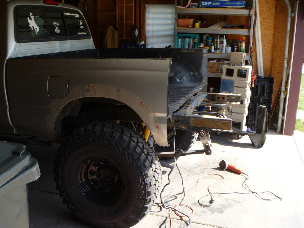

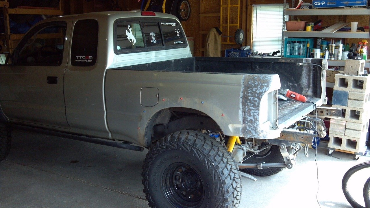

    Not as fast as I'd like.:eek: I've been taking my time and doing other things too. Not to mention prep work and measuring took forever. Sure didn't help that my bed is a little tweaked from when a coworker back into the truck and I also bent the very end of the frame and bed mount when I pulled my buddy's F-250 out of a swamp.
    Hey, with your bed bob, did you use the bed mounts on the back end of the bed? They seem really close to the next set of mounts and I was thinking of just leaving it. How much did you take off anyway?

    I will be wheeling on sunday! :D Also, I took out 12 inches of the bed and used the stock mounts still.

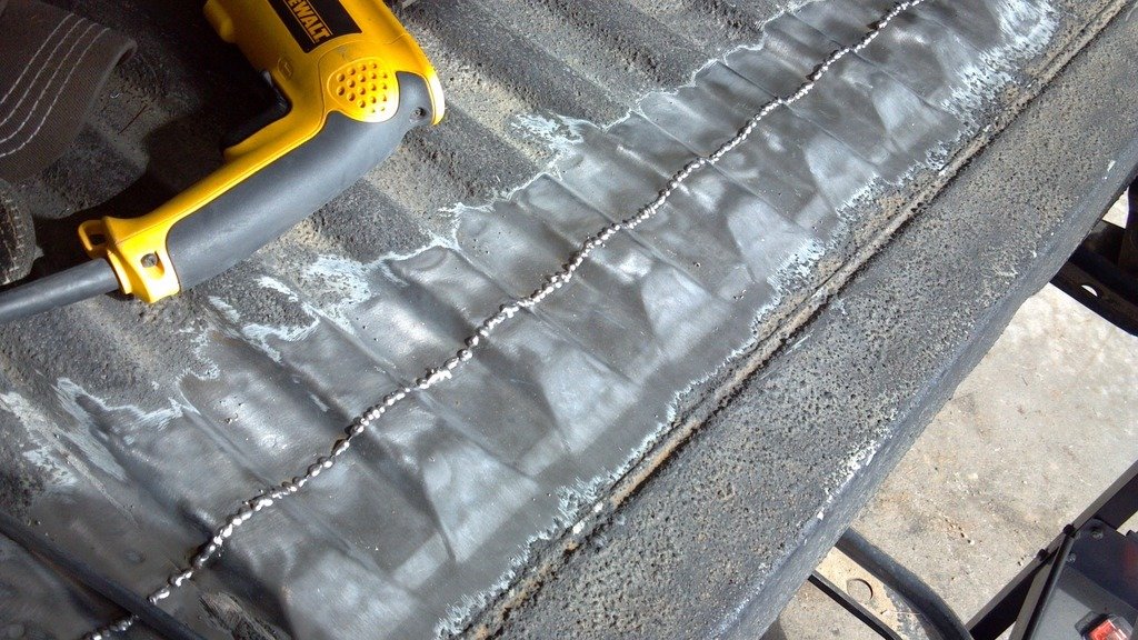

    Almost done with the bed. Gotta do the bondo and paint it up. Turning out pretty good so far.
    Welds after they've been cleaned.

    i bet you could get the welds flatter if ya wanted to..

    Probably. I don't think I had the voltage high enough so I was tacking a little longer than I probably had to. They seem to be holding up pretty good though.
    MIG .024 wire with argon/CO2, which I ran out of just as I was finishing up:eek:

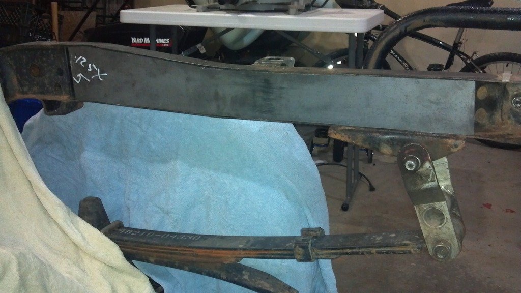

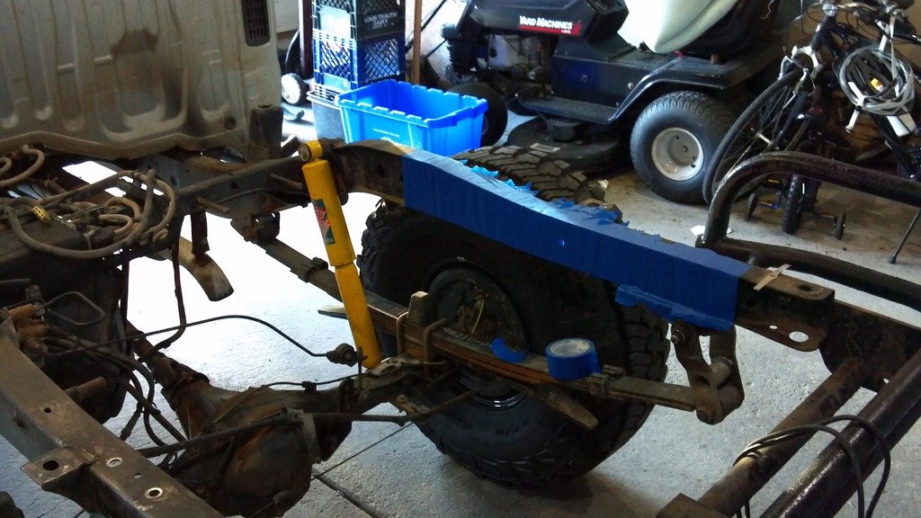

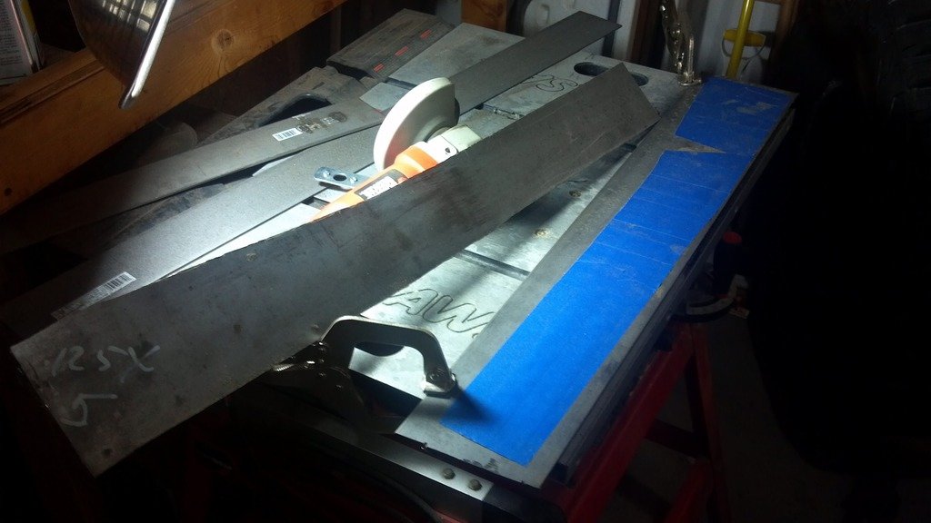

    On another note, I started working on boxing the frame. Saw this technique on TTORA and it seems quite accurate with VERY little trimming to make it fit. I did put a backing strip of tape behind the others so they wouldn't fall apart, then just cut it out inside the frame and placed the template on the blank steel. Really easy to do. I'm using 1/8" for boxing.
