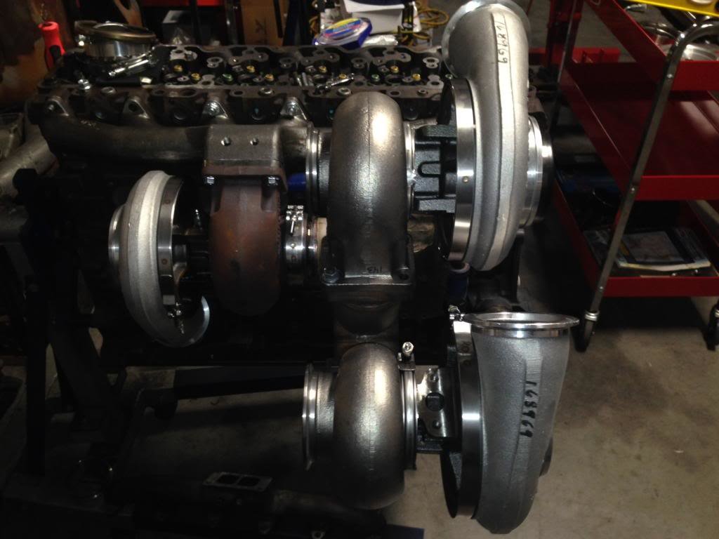

    I think you'll still have to clean the metal no matter what you do... I say if you're done with a piece of steel, paint it. Won't rust anymore.

    I still suggest triple turbo... WOULD YA JUST LOOK AT IT... JUST LOOK AT IT !!!!!!!!!!!!!

    Compound turbo is not a bad way to go.

    8,406
    Hampton Roads, Va
    SR5 4x4TRD
    Intake, exhaust, lift. Typical stuff.
    Its a big headache... To get some low end torque, may not be a bad idea though.

    Twin charge would be easier.

    Maybe. You would want a way to bypass the S/C if +6k rpms is the goal. Def 10k. I don't think the S/C bypass valve will work but could be wrong.

    Yea but you wouldn't need that high of revs with twin charge.

    Yeah he was more interested in instant boost though; he probably could have just got some smaller turbos for that. Also noticed he wasn't using twin scroll turbos due to the log design header. If he had a better header design and used twin scroll turbos, he would have seen at least a %10 decrease in spool rate.
    What I like about his setup is there isn't that inherent drop in power mid way through the RPMs you see on most sequential turbo setups. Its a pretty smooth dyno. But like any sequential turbo setup, its complicated as hell.
