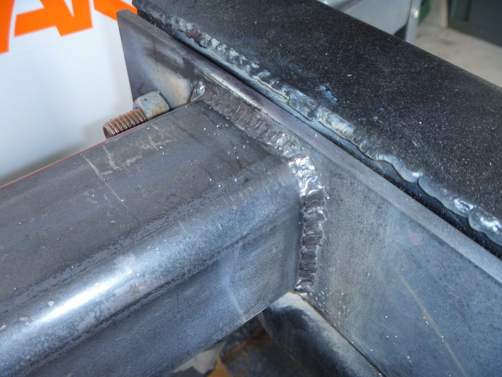

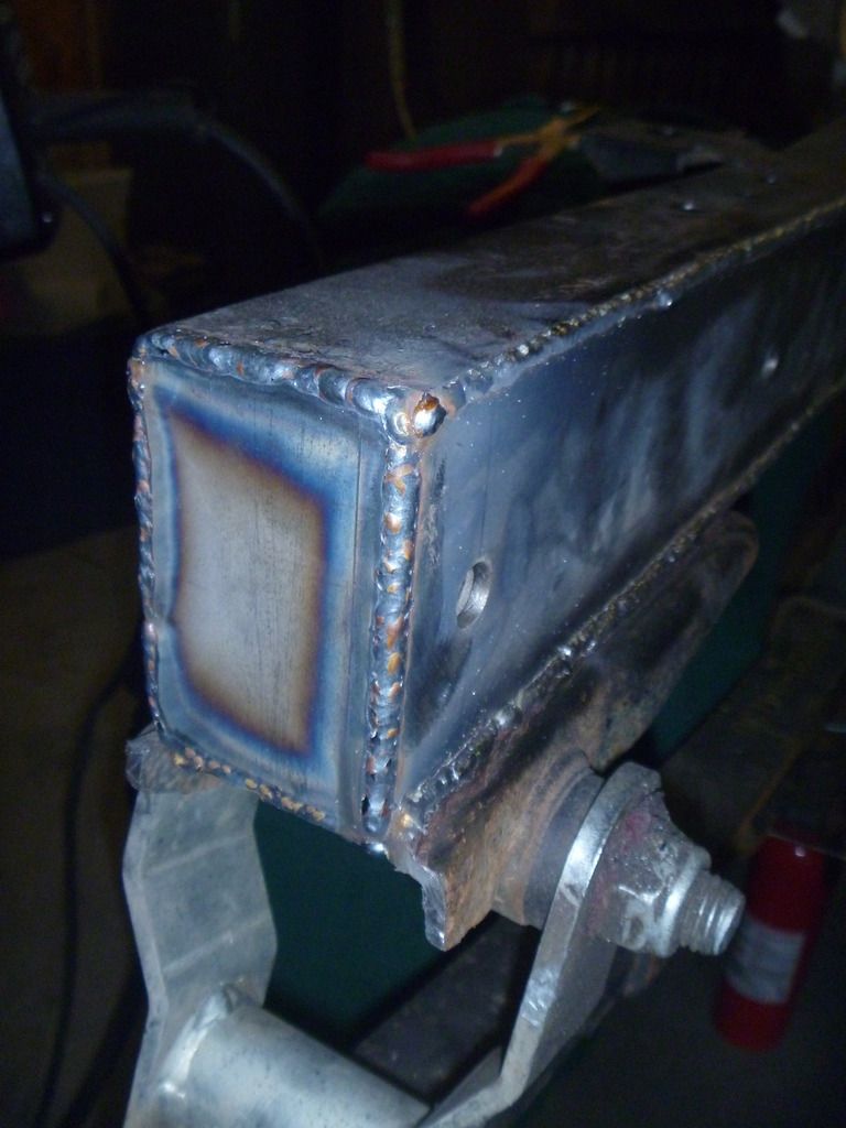

    Thought I'd post some quick pictures, progress has been less than desirable (surprise! :rolleyes:) here are some of the welds. The last one is with flux core on 1/4", neither of which I've used before working on this crossmember.
    'Should' have the bumper done tomorrow.

    Welds are looking better all the time man!

    Hobart's have wonderful flux welders. They work so well. Good work man!

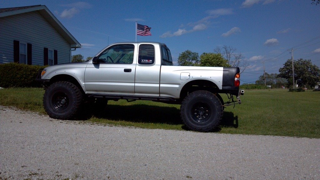

    Didn't have time to finish today, but here's the progress so far. Excuse the crappy cell pics

    The bob looks clean as a mofo!

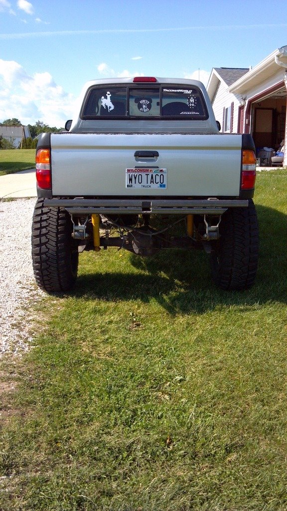

    How is your license plate mounted to the tailgate?

    Good lookin truck!!!

    Knowing Wyoming boyz... probably with superhuman snot
    :p

    I plugged in the tail lights and all the lights work just fine with the exception of the red lights that are supposed to be constantly on in conjunction with the headlights (which work fine too). They don't seem to be working at all, and can't get the license plate lights going either. I don't understand because all I did was unplug them, did the bob, and plugged them back in. I'm completely lost.:(
