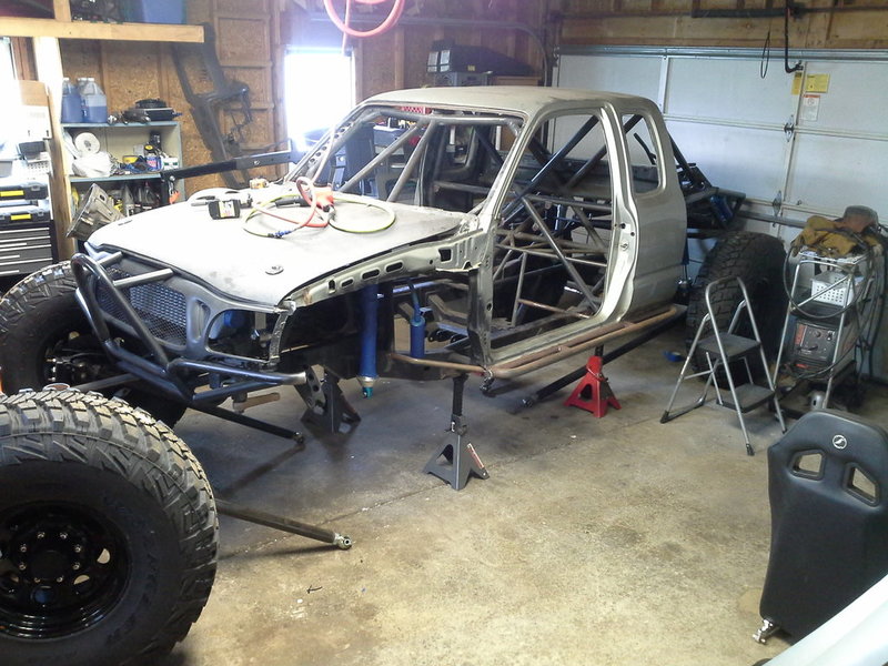

    I spent a good portion of the afternoon trying different things. I cranked the links as short as I could (albeit 1" :rolleyes:) and did some trimming and it doesn't seem as bad as I thought. I can't shorten the links since the bungs are fully welded in.
    Easiest way to make it work would be to cut off the main link crossmember and reweld it 1" - 1.5" back. Which should work really well in my favor because when I installed it (one of the first parts of the SAS project), the crossmember was positioned with the drivetrain mounted 4" back. When I rebuilt my motor mounts, I moved the drivetrain back another 2", so the position is now off a little. Workable, but off. Secondly, I cut my rear links shorter than I should have, and there is too much thread exposed. So moving the crossmember rearward should even everything out again and give me some room to fit the 40"s.

    I moved the crossmember back 1 3/8" and that seemed to do the trick. Today I cut off the old frame end panhard bracket and made a new one. It's a bit narrower and lighter than the original. I'll get pics when I get it fully welded onto the frame.
    With the crossmember moved back and the links as short as they will go, I have ~1" of clearance so I'll move it forward as far as I can.
    [​IMG]DSC09922 by Jonathan K, on Flickr
    But I was able to fully flex it out. Glad I went with the 14" shocks because this is plenty, IMO. With the rear tires still on the ground, the lowest part of the front passenger tire is 43" from the ground.
