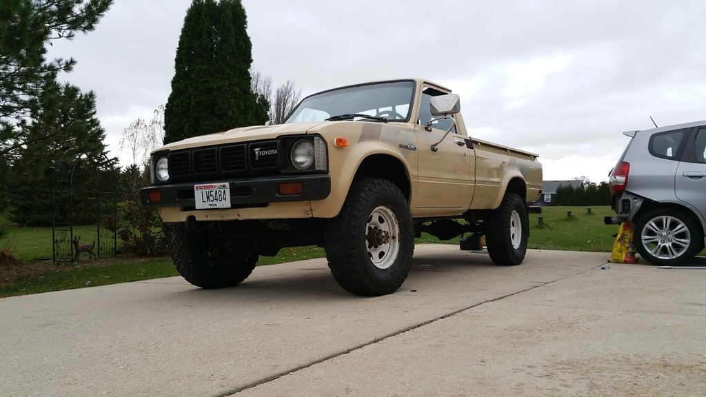

    Tires looking good! :thumbsup:
    :popcorn: waiting on more Tacoma pics

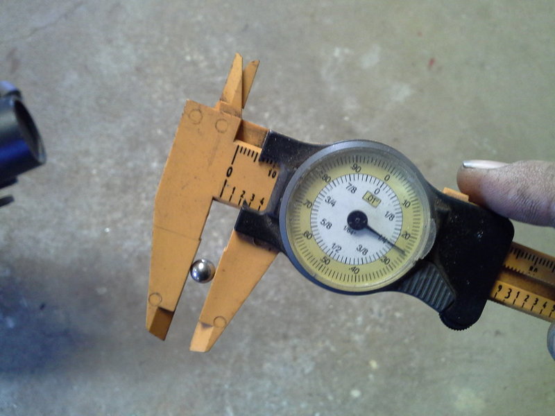

    Can't catch a break. Radiator went kaput Friday. Yesterday I changed the oil in the rear diff and trans, only to find a ball bearing sitting on the magnetic drain plug. Based on some forum threads I thought it was an input bearing issue, but it seemed too small to be that and the local guy that does transmissions/diffs agreed, more like a detent.

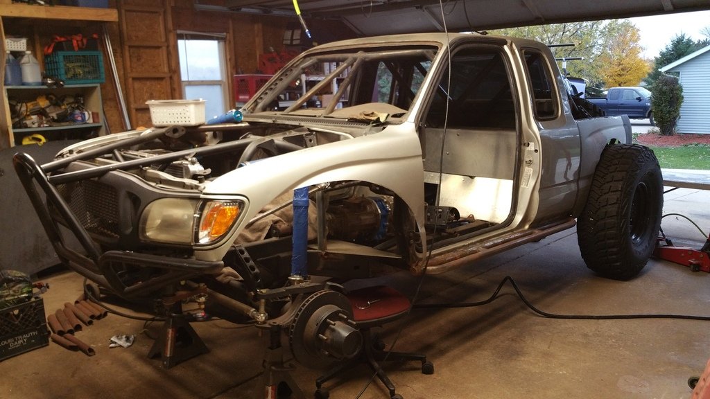

    Gonna try cranking out some real progress this evening on the Tacoma. Honestly kinda nervous about trying to get the aluminum portion of the firewall together because I still for the life of me can't TIG weld a decent T joint. I can't get the arc to stop jumping to the closest of the two pieces. :frusty:

    If that came out of the t-case that looks like the detent ball.

    Came out of the transmission

    Jon, don't know if it could affect you're truck, but I remember the early 5sp's had a defective front countershaft bearing, (83 and earlier). My 83 trans went thru lots of abuse before it shit the bed at just over 100k, had to replace the trans. When I pulled the old trans, there was only 4 balls left in the front countershaft bearing. I don't remember how big they were, but that might be a place to look if it relates to your trans?

    The shift detent balls are .31. The rest of the ball bearings that hold stuff in should be .24, this is based off a gear drive tcase. If it came out the trans who knows WTF it could be, however its not a detent ball lol.

    The majority of relevant threads I can find point to the input bearing being a common problem with these particular transmissions.
