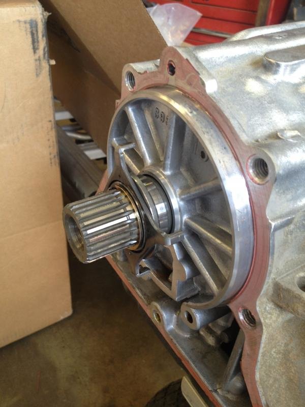

    The most obvious difference is the length of the output shaft.
    2WD
    [​IMG]IMG_20160407_172024195 by Jonathan Krajnak, on Flickr
    vs. the 4WD
    edisonsteve-albums-1994+toy,+3.4v6-pictu_945c65788a4e2bf197376355670d70cbe5060890.jpg
    So I needed to chop approximately 2.1" off of the 2WD output in order for the crawl box to be mounted.

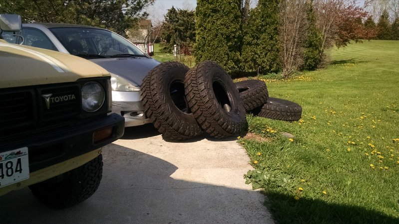

    But not before this. Goodbye 40"s. :anonymous:

    Noop. 37"s. Eventually. Wasn't in a hurry to sell (hell, I wasn't even sure IF I'd sell them). On top of it being a real pain to stuff, flex, and clear 40"s lock-to-lock with my setup, there's a 'no bigger than 37" rule for 4500 class. Plus, I'm toying with the idea of going with re-centered humvee wheels and tires for screwing around with and won't break the bank if I destroy tires left and right.
    The cash couldn't come at a better time. I need about $1k to restore the '81 before it becomes too far gone. The rust is creeping up fast, the windshield leaks, the wiring needs to be replaced and the engine needs a rebuild. BAD.
