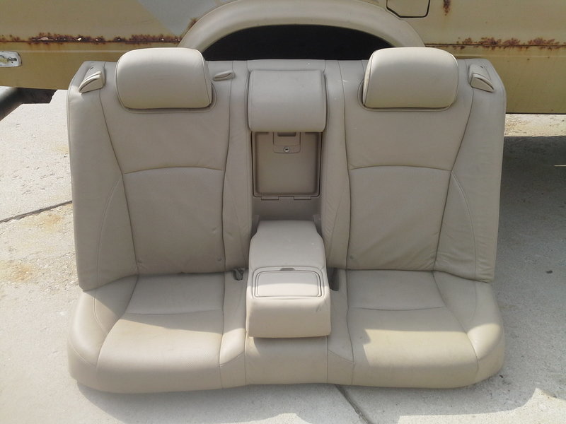

    The bench seat should be an interesting mod. I'll have to make a frame for it, but whatever. I scoured the local junkyard and found this rear seat out of a 2008 Lexus ES 350. I wanted something comfortable but didn't really want to shell out $400+ for aftermarket

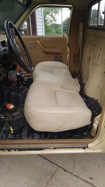

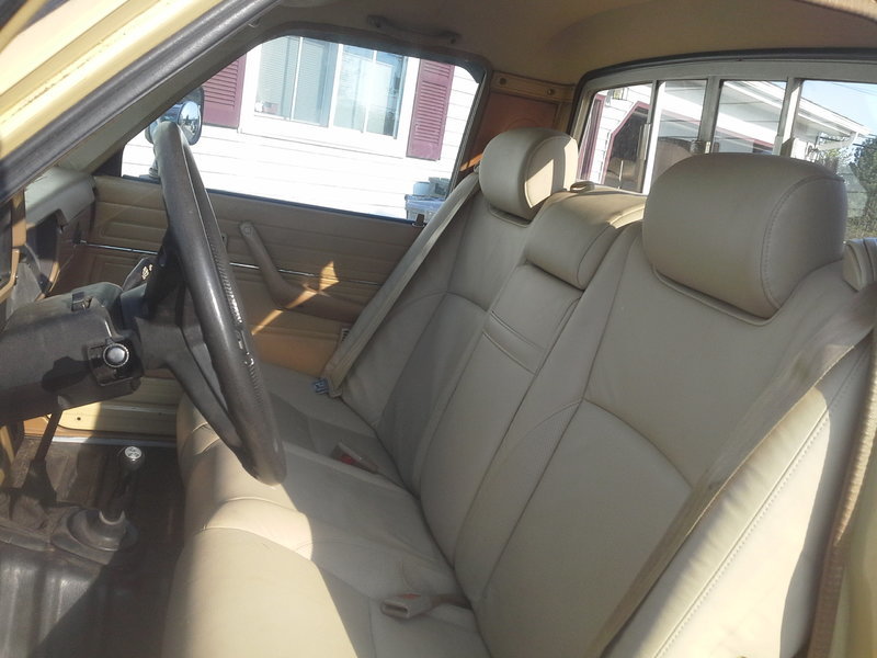

    I finished up the seat bracket and sliders, but I'm having to do some heavy trimming on the back portion. I'll sew/hem the cover so it still fits nicely. I'm undecided on if the back should be fixed or allow to fold.

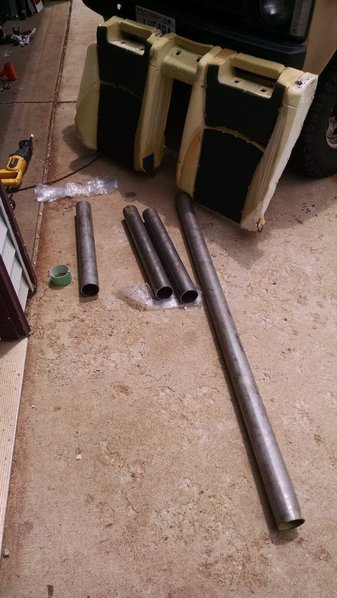

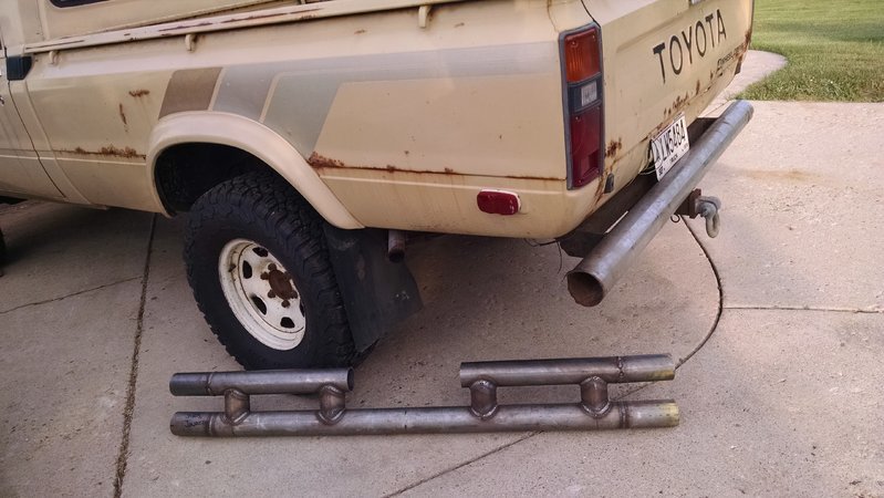

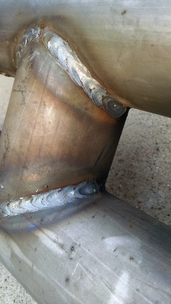

    I still have to cap the ends and grind some of the welds, but it's done for the most part. Waiting on the brackets until I cut off the angle iron hack job that is welded to the frame. :facepalm:
    $70 of 3" x .120" wall DOM

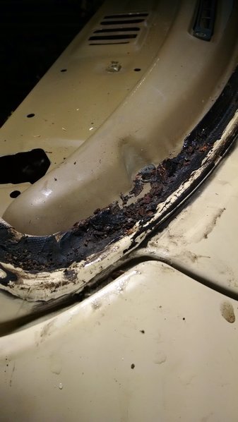

    I wish I could, but finishing the Taco anytime soon is cost-prohibitive. Adding to that, time isn't on my side with the '81 and it had to be fixed before it was too far gone. I suppose with age, the windshield seal shrank and allowed water to pool and eventually rust completely through. I tried covering it with silicone, but it only slowed the leaking into the cab and corroding the electrical components.
    Windshield frame looks like this on both sides...
