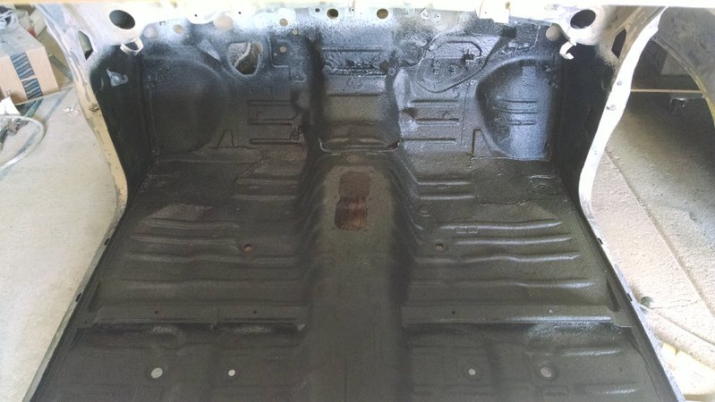

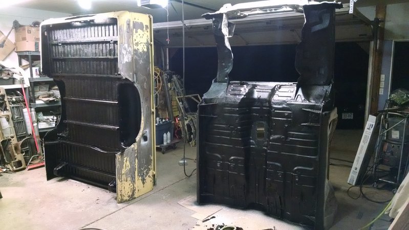

    A few updates. Obviously I didn't get it done in the 2 weeks like I was hoping. I was well on my way, but I'll leave it at "circumstances beyond my control".:frusty:
    Finished patching all the rust. The bed had more than what initially appeared but still nowhere as bad as the original bed. To ensure that I don't have to deal with rust again hopefully ever in my lifetime, I completely stripped, cleaned, primed, and bed lined the entire underside of the cab and bed.
    In critical areas that are most likely prone to rust (usually along seams or where dirt/salt/etc accumulate), I used Raptor Liner. Since it's kind of expensive, I tried to stretch the dollar by covering the non-critical areas with Rustoleum bed liner. I used one bottle of Raptor liner and 1.5 gallons of the Rustoleum. I did essentially the same thing inside the cab, using an entire bottle of Raptor (concentrated more towards the front floorboards) and finished up with Rustoleum. When I emptied a bottle of Raptor, I refilled it with Rustoleum so I could use the u-pol spray gun and get a similar texture.
    I also picked up my short block from the shop today. Not only were the rings bad, but they had wallowed out the grooves on the pistons so those had to be replaced as well. $250 in parts from LCE (rings/pistons 0.020" over)... block and crank cleaned, new freeze plugs installed, and bore/hone was another $525. Ouch. :(
