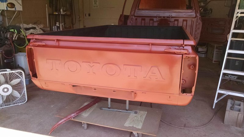

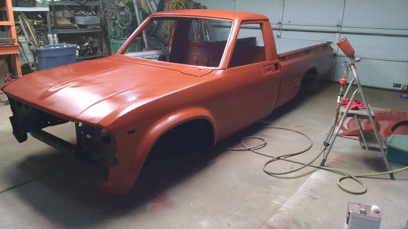

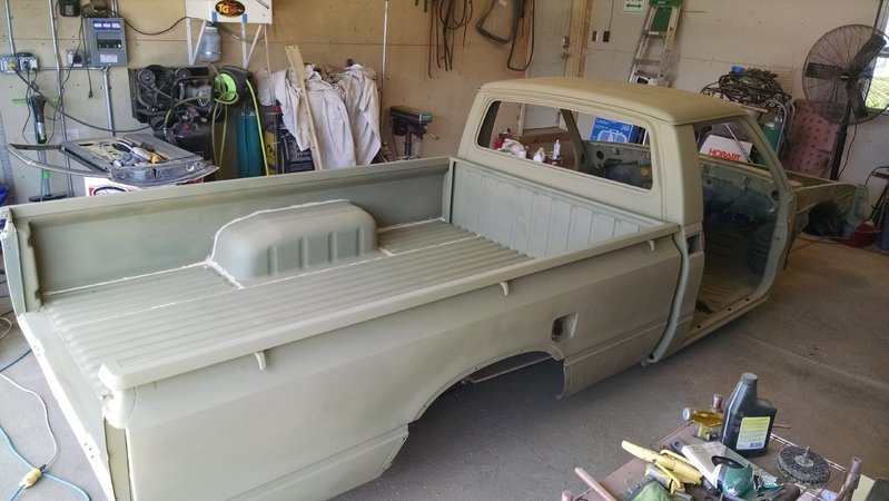

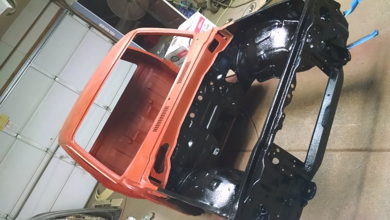

    Either I'm too damn meticulous for this project or it requires that effort. Regardless, next time I'm leaving this shit to the retired guys with more time on their hands. :anonymous:

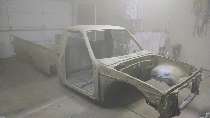

    Stripped virtually every square inch of paint off the truck beforehand which took up most of the time.
    2 coats of etching primer and some seam sealer to replace any of the old glue I removed.

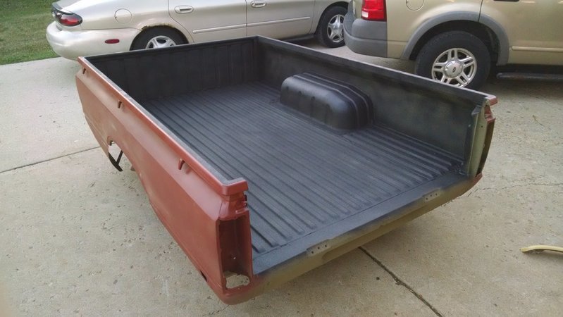

    Wanted to get at least one coat of base on before I mount the doors and tailgate. Lightly sanded it to prep for the second coat. Wasn't sure what to do about the firewal/engine bay/radiator support, so F it... I bed lined the entire thing (drying as I write).
    For reference's sake, here's what just about 2 bottles of Raptor will cover. Obviously not thick by any means, I saved them to use as an extra layer under the tintable kit.
    Also... insulation/sound dampening material from raamaudio.com, a new carpet with mass backing, and new front fenders arrived in the last few days.

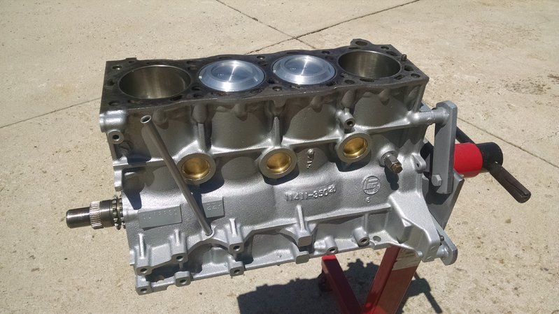

    Finally have the short block back together. I didn't realize the thrust bearings weren't part of the package for the main bearings, so those had to be ordered and I ordered new valve springs while I was at it.

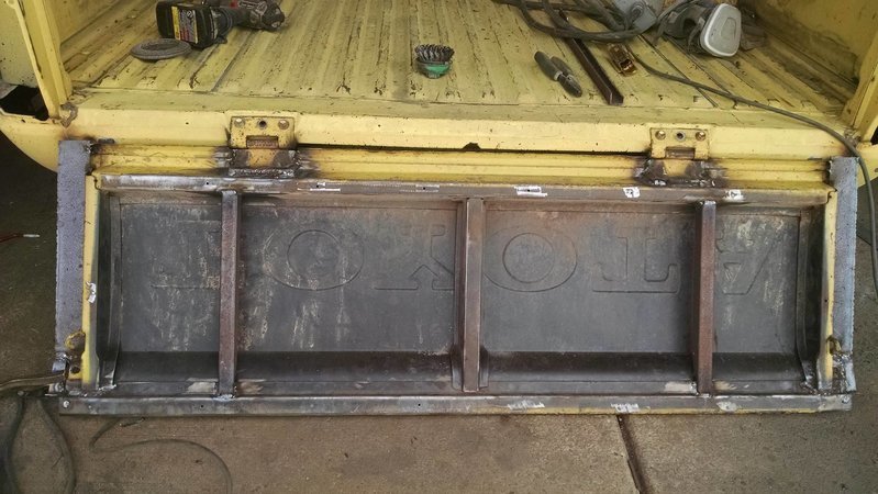

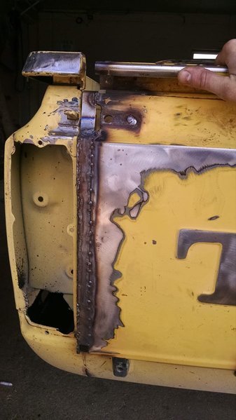

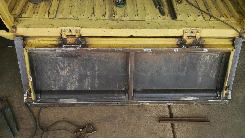

    Just about finished up with the modified tailgate. I pulled it from a '75 HiLux in CO.
    Since it was too narrow for the '80 bed, I added material to the top and sides in addition to relocating the latches and hinges.
    I also opened up the back panel and added square tubing for load support.
    Still have to make the lettering white, clear coat, and spray bed liner over-the-rail.

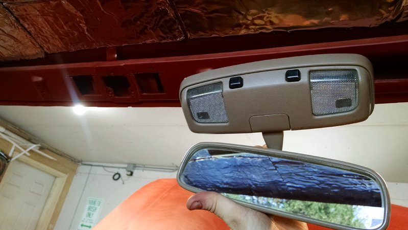

    I also cut out reliefs in the head liner support for upgrading the rear view mirror to one I pulled from a 3rd gen 4Runner.

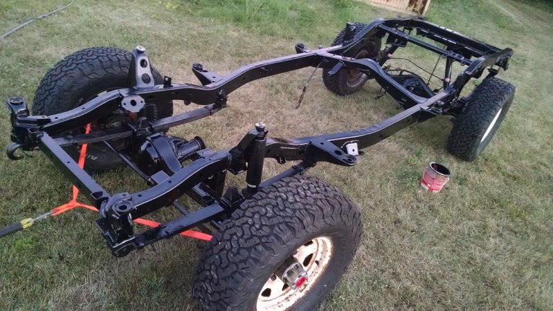

    Finally getting the POR-15 on the frame today. Who needs a big ol' diesel for towing? @Supra TT :luvya:

    I ordered a gallon of POR-15. Waaay too much. Just over a quart did the entire frame, gas tank skid, and axles.
