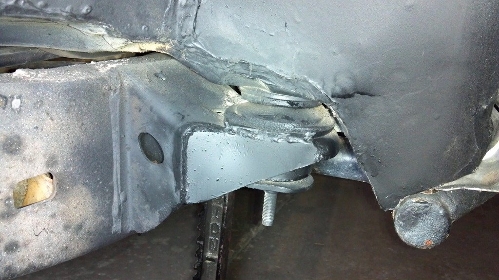

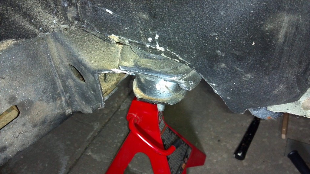

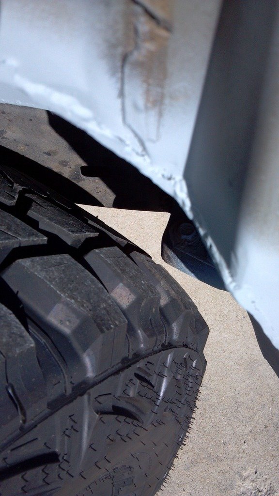

    Did a body mount chop today. Don't know of anyone who has done it to a 1st gen. I didn't like how close the tires sat. The alignment shop said it would be an extra $90 to move the caster farther forward rather than simply being in spec. F that! I'll use some scrap 1/8", thank you.
    Welds look like shit on top because at the same time I was welding, I was trying to keep the rubber gasket on top from burning too much.:eek:

    Hows it look with the tire back on??
