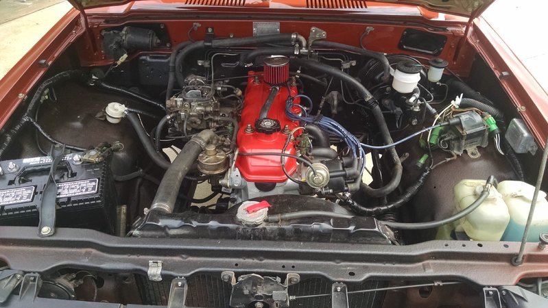

    Been working on the wiring. Removed everything associated with the emissions and also repairing damaged/corroded connections. Tried starting it tonight but no luck. Not sure if I've primed it improperly, a bad ground somewhere, or if there's some fuckery going on with the ignition.

    Looks logical to me...

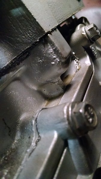

    I noticed some oil pooling after the first start up. Clean it, and noticed it after running it again today. Other than the main cylinder head bolts there's one smaller bolt at the very front, underneath the drive gear for the distributor. Looks like the timing chain cover is cracked right at the shelf where it bolts to the cylinder head. I likely wouldn't have noticed it had I painted it black. FML. Is this something I can JB weld? I really, really, really don't want to have to take it apart again. I can't TIG it. Wayyy too much contamination of the metal.

    Oh that fuckin sucks. Couldn't hurt to try JB weld :notsure: Whats the worst that happens, you leak oil?

    Yeah, worst is have a little oil leak. I'll give it a shot here soon and see what happens. In the mean time, I finally took it for a test drive today to finish adjusting the carb and make sure everything was working. Feels like a completely different truck!

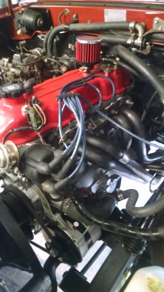

    The OEM seat is in temporarily until I finish the bench. I need to wiring for accessories, paint the wheels, and modify the stock intake.
    I rerouted the front valve cover opening to a tee so both front and back can use one crank case breather, rather than getting that oily mist sent down the intake. Hopefully that'll keep things cleaner in the long run.
