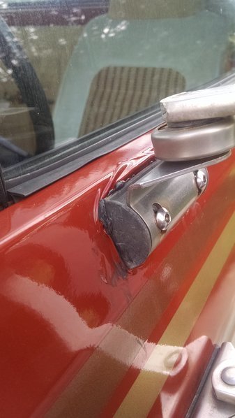

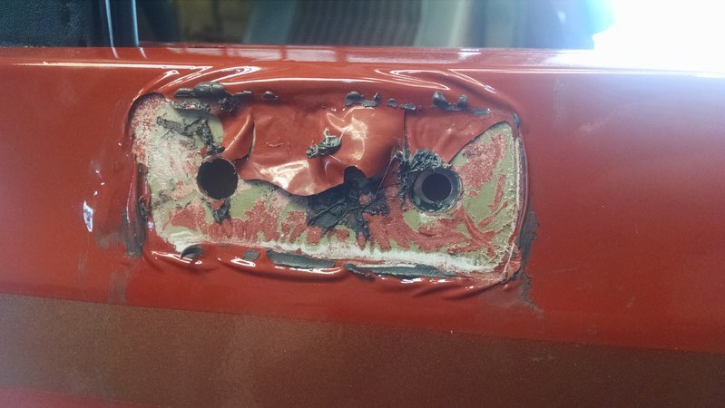

    The plastic mounts for the mirrors are hollow, which was trapping water and rusting out the bolt holes. I tried filling in the bases with rubber/silicone sealants, but apparently it chemically reacts to the paint/clear coat. FML.
    In the process now of trying to sand it down and repair the damage. I'm trying to learn CAD and have access to a 3D printer, so my first project is to re-engineer the plastic bases so they're solid but have grooves for O-rings around the bolt holes.

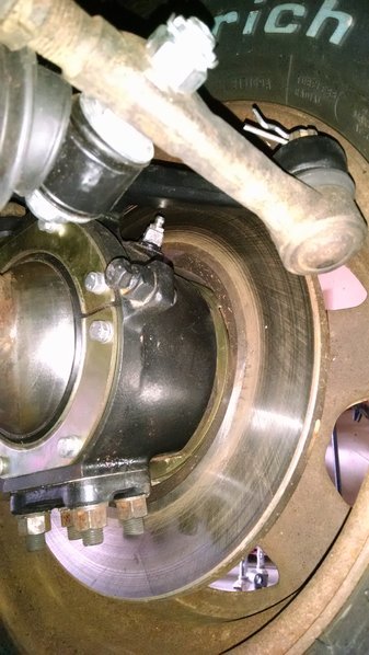

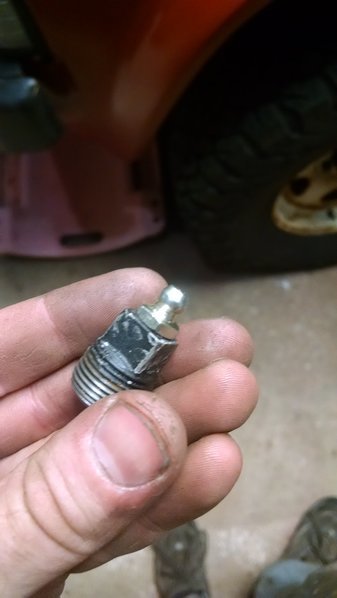

    Drilled and tapped these useless plugs for zerk fittings on the knuckles

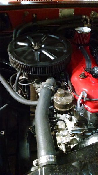

    Finally finished the engine. Replaced seals and diaphragms on the carb and it runs quite smoothly now. Adjusted the lash on the valve rockers. I also cut up the stock air filter housing (running a reusable K&N filter) so it wouldn't be in the way of the crankcase breather.

    3" lift? A.R.E cap 285/70/17 moto metal 955 17x9
    Those useless plugs are for filling the balls for the birfields, one school of thought says use 90w, the other says use moly grease, which is what I did on my '83. But you need to be careful as there is no seal (or not a good seal) between the ball and axle, over time my axle became filled with a mix of moly & 90w, (not good).
    Pulled the drain plug, nothing came out, pulled fill plug and there was a wall of black goop behind it. Cost me a lot of money to get the axle flushed out of all the goop (didn't have anyplace to do it myself), just saying so you know what can happen.

    I completely rebuilt the axle and used trail-gear inner axle and wiper seals. Packed it with bearing grease. I can't imagine how oil of any weight would stay in for any length of time. Cleaning out that axle was the single dirtiest part of any project I have done.
    http://www.trail-gear.com/product/4749/trail-safe-knuckle-ball-wiper-seals#.V8j8S1uU270
    http://www.trail-gear.com/product/5047/trail-safe-inner-axle-seals-pair#.V8j9K1uU270
