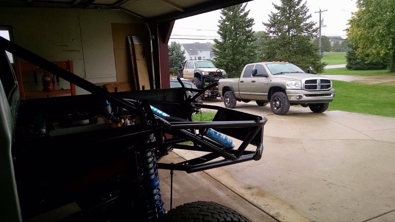

    Also picked up the cap on the same trip. It had been sitting for 10+ years so there was plenty of moss growing on it. A couple minutes with the pressure washer and it's looking almost new again. Luckily it was sitting under a tree out of the sun, so the gaskets are still in pretty good shape. There's a small crack on the hatch, but I don't think it would be difficult to fix. I'll color match it with the truck.
    [​IMG]DSC00323 by Jonathan Krajnak, on Flickr
    [​IMG]DSC00322 by Jonathan Krajnak, on Flickr
    just about done with the back half of the Tacoma for the time being. Re-welded some of the intersections, added the bump cans, limit straps, and dual battery tray. I also welded the landing pads on the rear axle as well as adding a tab to the shock mounts to make the limit straps double-shear. I'll get pics up this afternoon when I get everything remounted.

    Holding off on the 'lid' for the spare fluids until I get the rest of the parts for the fuel cell and figure out the best mounting solution. I welded tabs on the tubing located on either side of the fuel cell for the storage containers I'm planing on adding. Drivers side will house the ARB twin compressor and air hose. Passenger side will hold recovery straps, etc. I loaned out my dimple dies so the upper mounts for the triple bypasses will have to wait as well. Other than that, I think fabrication on the rear is actually good to go. :eek: Also, since I upgraded to 220v, I went ahead and ground down/re-welded most of the tube intersections.
