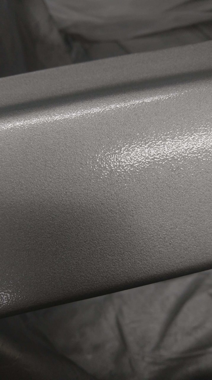

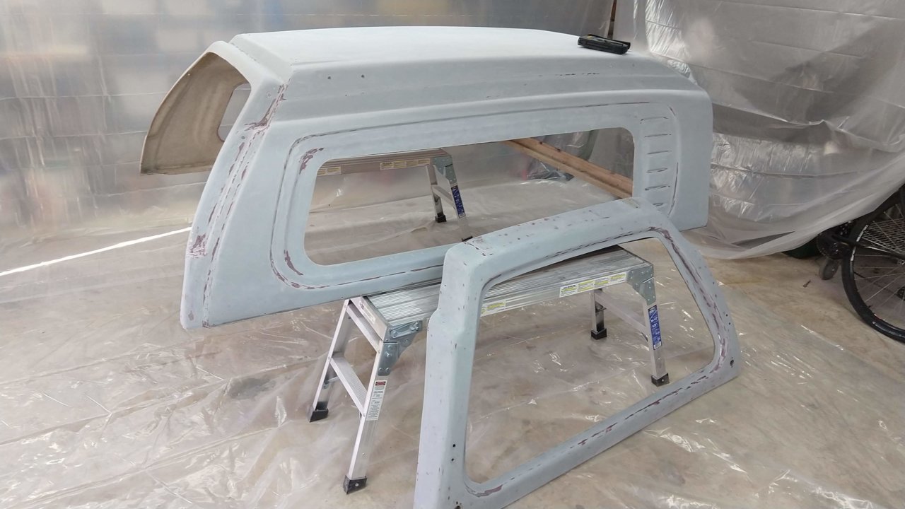

    Finally got around to repainting the cap for the '02. What a PITA. There was 3 coats of paint and I made the mistake of sanding it off, rather than taking it to a shop to get removed/redone.
    I used a single stage paint which was apparently also a mistake. It may be fine for solid colors, but not metallics. When applied heavy enough to create a smooth surface, the metallic particles tended to flow together rather than appear evenly distributed. I ended up applying it evenly, but intentionally leaving a textured/heavy orange peel surface.
    Good enough, I guess.

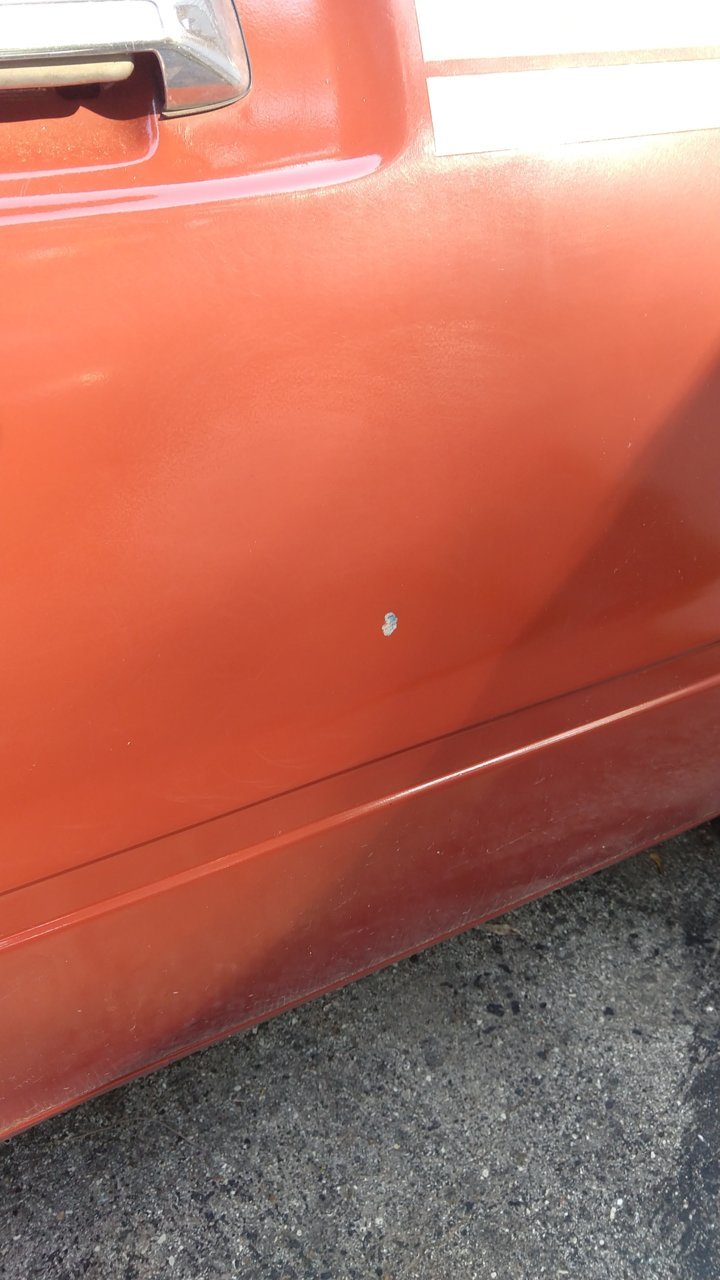

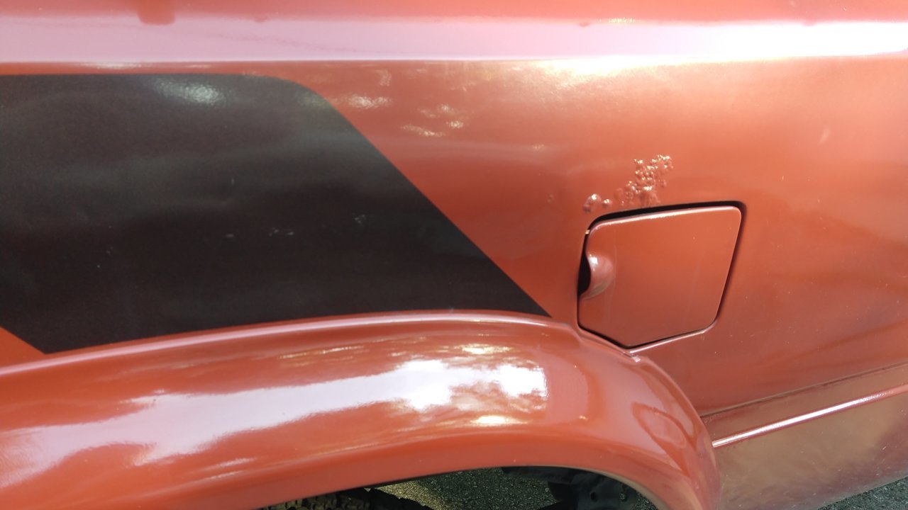

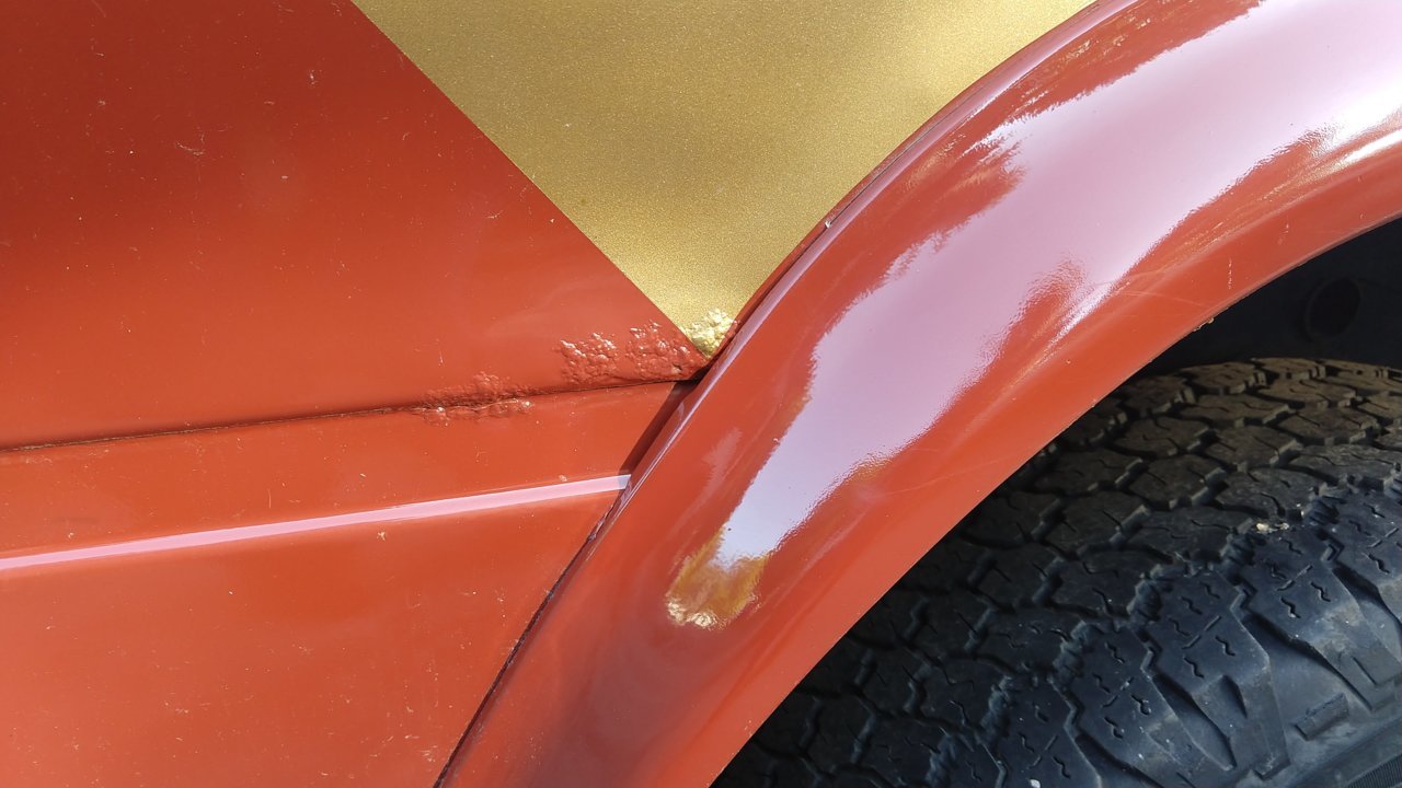

    I'm also in the process of cleaning up the '81 before it goes. But I need some opinions.
    There's 3 options with regards to the paint...
    #1) Leave it as is.
    #2) Attempt to repair some or all spots that need attention.
    #3) sand down the bed and doors and start over.
    When I initially repainted the truck (4 years ago??) I sanded down to bare metal and used an etching primer. There has been several spots that have very slowly been bubbling up. Someone recently told me I should have applied an epoxy sealer on the bare metal first (which I didn't do, and don't recall that being a needed step).
    That's the best guess I have as to why it's currently acting that way. In addition to that, I've been considering a do over because someone gave me a door ding on the passenger side door, and there's a defect in the paint around the mirror on the driver's side.
    On one end if I leave it as is, but clean up/finish the rest of the truck, I was gonna shoot for $6-7k. If I completely redo the paint, I was gonna try and get $8-10k out of it. Is the extra effort worth my time?
    Pics of the faulty areas

    Probably not worth it I'd think

    I'd argue not worth it for those prices?
