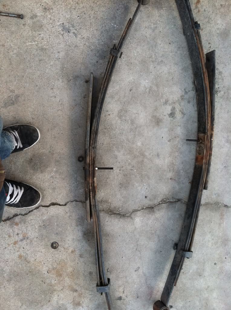

    That's what I wold do... But you're going to have get the chevies on the truck before making any important decision about shock location/travel length I think.
    If the chevies were able to withstand more negative arch, than going through the bed might be a good idea imo....but that unfortunately, that is one of they're weaknesses, so I don't think that's necessary. It's just a bummer that we wouldn't get much up-travel with that set-up.... :\

    Yeah, good point. I should get the chevys on before I figure out shock relocation. From the looks of it, if those overloads (or whatever) weren't shaped the way they are or stiff as the are, they probably wouldn't deform the leaf pack like that.

    Yeah, he cut those overloads in half on one side... he really should taken both overloads out. But he has gone through 4 or 5 sets of chevy leaf packs because he's not running a large enough bumpstop and he let's them flex way too negative.... Just trying to say that the chevies do not survive well when allowed to flex very negative.
