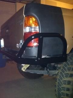

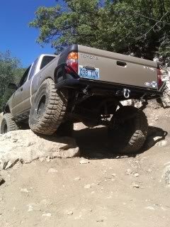

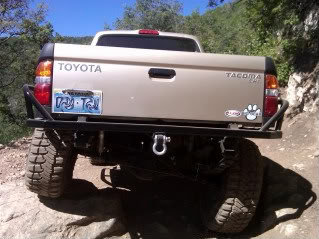

    Shamelessly stole these from TTORA for future reference. This is exactly how I want the bed bob and bumper to turn out.

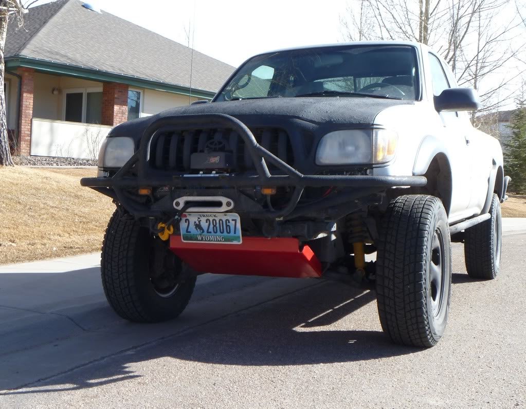

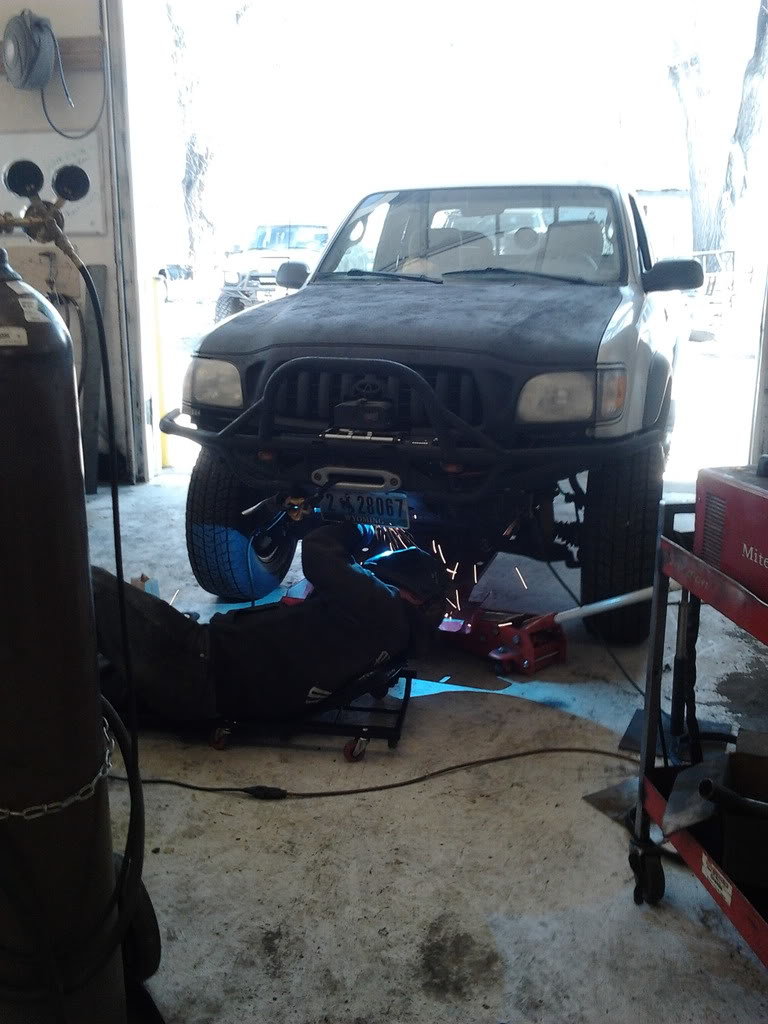

    Small update today. The skid plate was mounted to the OEM crossmember and was hanging too low, IMO. I was picking up some parts from Addicted Offroad so I asked about getting it relocated. They got it remounted to the crossmember for the bumper, looks a lot better! Props to Scotty & crew for the help.:D
    Looked like this...
    Closed the gap!
