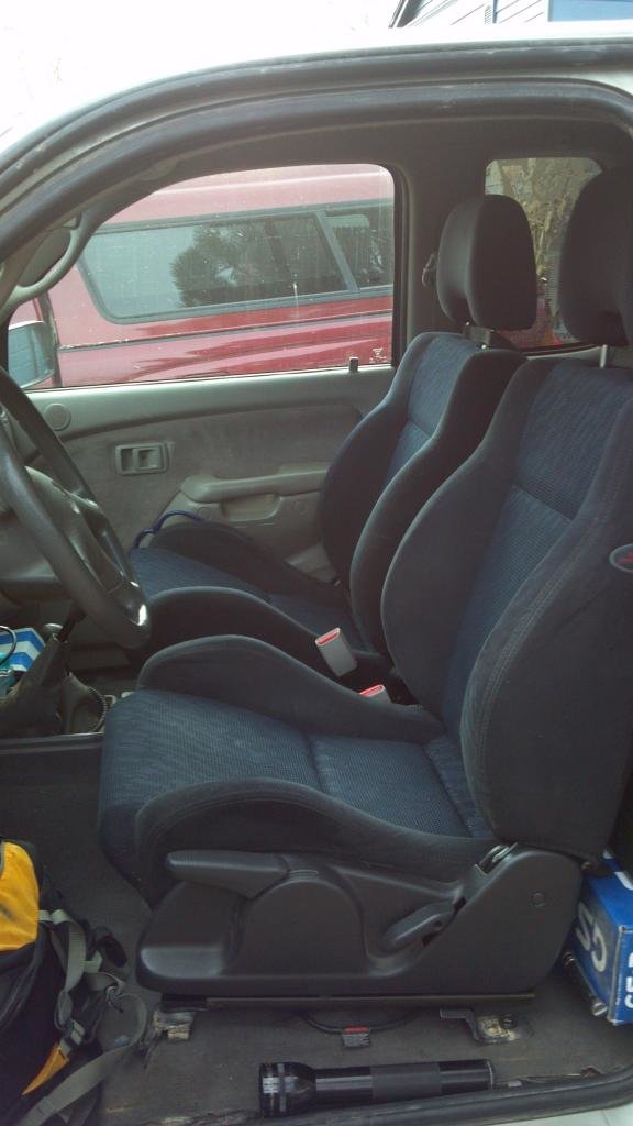

    Those look exactly like my subaru wrx seats :D
    It took a lot of modification for you to install? My install didn't require any welding and only some modifications

    A bit more than I was expecting. When we initially looked at the seat fitment, Madjik_Man and I kept scratching our heads saying out loud 'how the hell did kmok do it??'.:eek: Got any specific pics of your mounts?

    I thought it would be easy for you after all the other things you've done to your truck lol. I didn't have a lot of trouble putting them in my truck. Maybe the difference between the mounting of my stock buckets compared to your 60/40 caused the problems lol. All the holes on the wrx seats were close to begin with on my truck. I'll try get you some pics of the mounting points tomorrow.

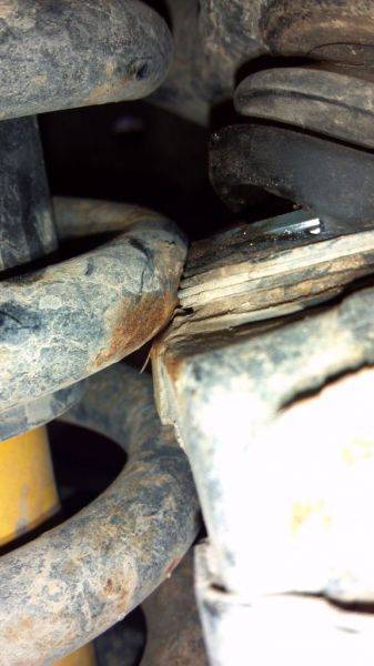

    Ball joints are toast. Spindle hits the coils during articulation/droop. Aftermarket UCA should fix that. Probably the last major mod to the truck for a long time.:eek:
    Probably go with Light Racing UCAs here soon. Looked at Camburgs but I'd rather have the maintenance free boot/ball joint set up right now than keep the uni-ball lubed properly. Anyone else run Light Racing UCAs on their 1st gen?:confused:

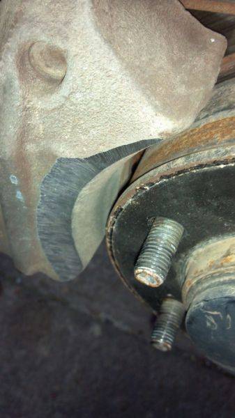

    Also removed the wheel spacers up front and ground the calipers to clear the D window wheels. Super easy, don't know why anyone wouldn't/couldn't do this if they're concerned that the wheels won't fit. Very little of the caliper surface needs to be removed. Odd thing though, seems like it cleared the passenger side just fine without grinding. Dafuq?

    Wow your BJ are shot!! Jesus haha
    And I never was comfortable grinding on something so important :eek: that doesn't look to bad tho..

    Yeah, there's really not much at all that needs to be removed. Insignificant to the integrity of the caliper, IMO.

    I've got LR UCAs on my truck. I haven't had any problems with them and my truck tracks and handles better with them on than the stock ones with lift. There are some pics of them installed in my build thread.
