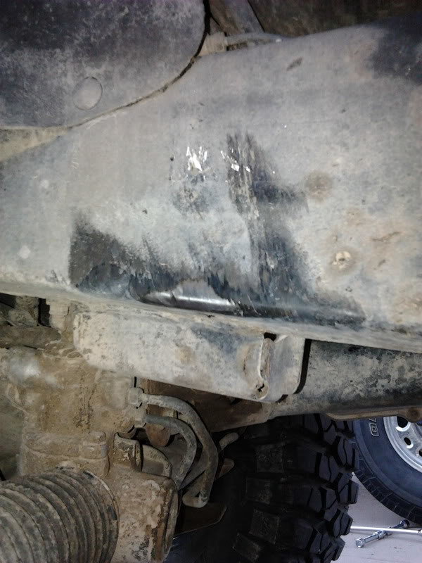

    With my frame issues, they had to build a crossmember from scratch on the spot with what they had on hand.

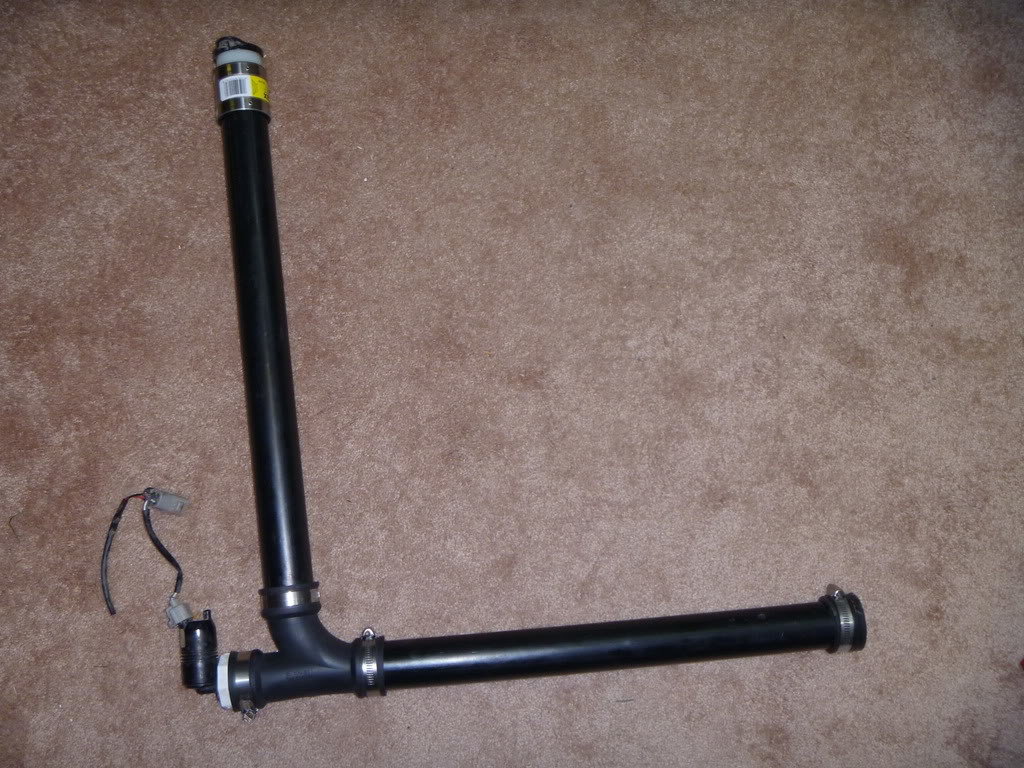

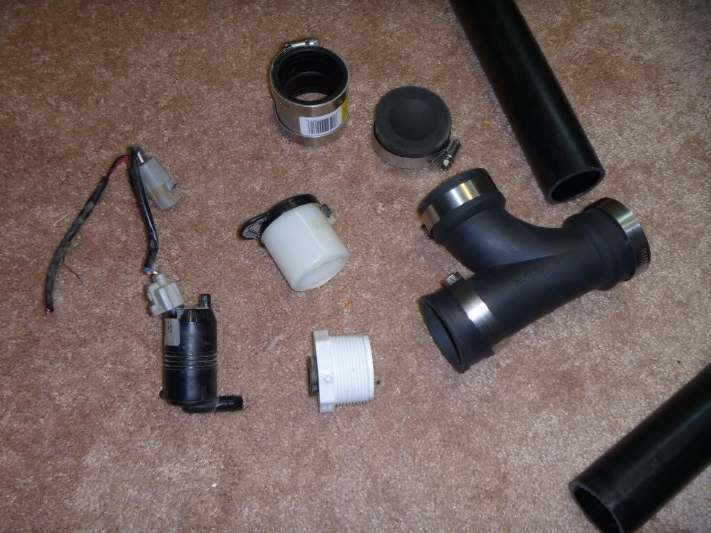

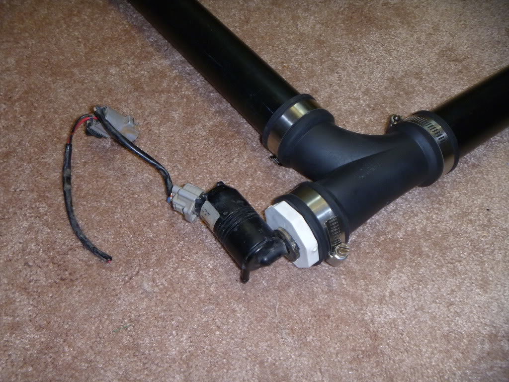

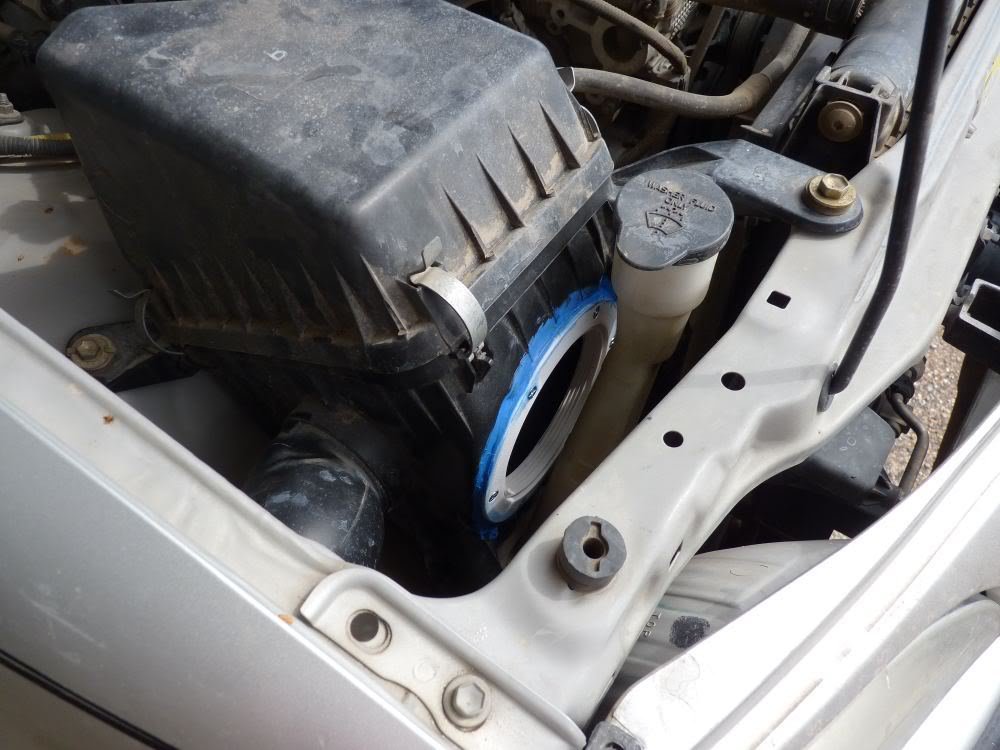

    Started working on relocating my washer reservoir. Since I removed the OEM bumper, it leaves the pump and the lower portion of the reservoir exposed to potential damage. Additionally the OEM reservoir sits right in front of the air box making it a PITA to open/close the deck plate.
    I built this one based on a write up on Expedition Portal. I used rubber fittings to make it easier to install and reduce the chance of stress/breakage. A PVC end cap to mount the pump, and a coupling to use the preexisting cap and filter. I used 1.5" dia. ABS pipe, 19.5" length for the lower and 21.25" for the upper. Decided there was no way I could use the low fluid sensor, so I gotta figure out how to bypass it. The whole deal is supposed to be mounted behind the radiator, around the fan...
    Gonna try tomorrow to figure out how to mount the damn thing. Please tell me if I'm doing something wrong. :eek:
