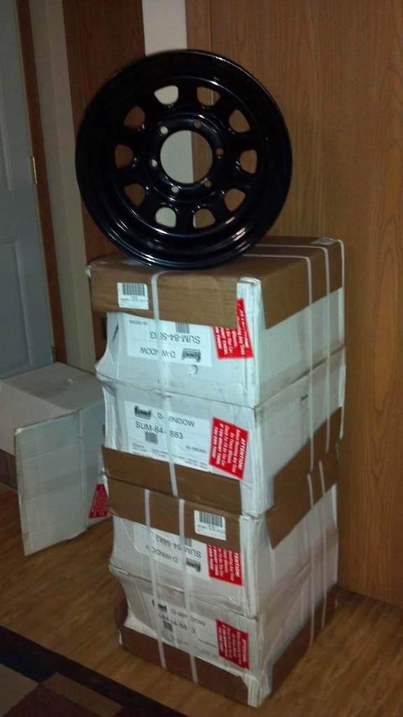

    I don't know of any D window wheels that are guaranteed to not rub the calipers. Spacers (even just 1/4") or grinding the calipers will solve the problem. I've tried both methods. Oddly enough, I didn't need to grind the caliper on the passenger side but had to on the driver side. :notsure: It's a simple method and hard to F up IMO.
    These are the wheels I bought.
    http://www.summitracing.com/parts/sum-84-5883/overview/
  13. Mar 24, 2013 at 2:16 PM
    #793
    BuzzardsGottaEat
    BuzzardsGottaEat Well-Known Member
    Apr 27, 2011
    #55669
    8,577
    Some Toyotas
    Round tires
    How much do those weigh^?
    EDIT: I'm thinking about having dedicated winter and wheeling set ups and those would be cheep and easy for me :D
    thanks if you happend to know off hand

    Can't remember exactly, but I'd say around ~35lbs. Not light by any means, but they work.

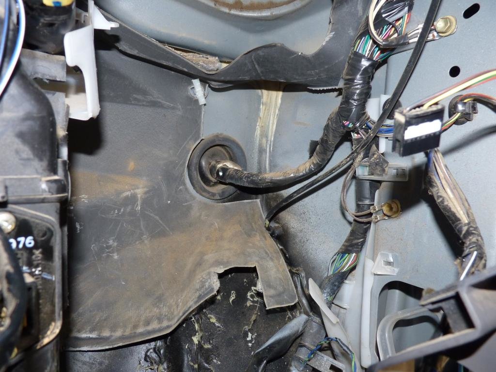

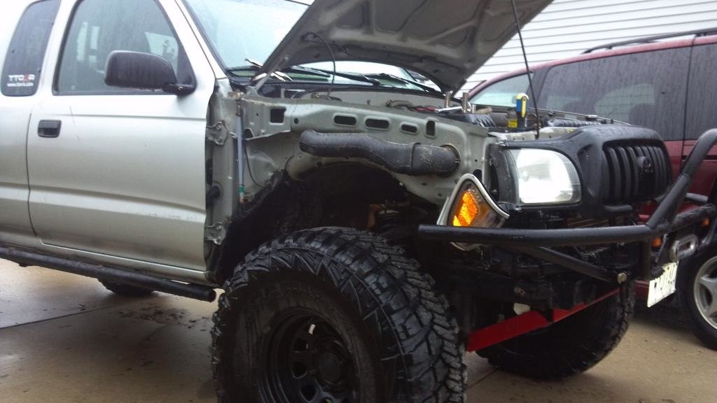

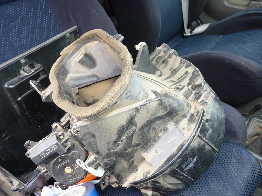

    Sooooo I was initially intending on JUST doing the in-cab snorkel mod I've seen a few times, like pictured here-
    But I'm trying to look ahead a little, when I (eventually:rolleyes:) SAS I figure something like that is gonna get in the way of shock hoops, trimming, ect.

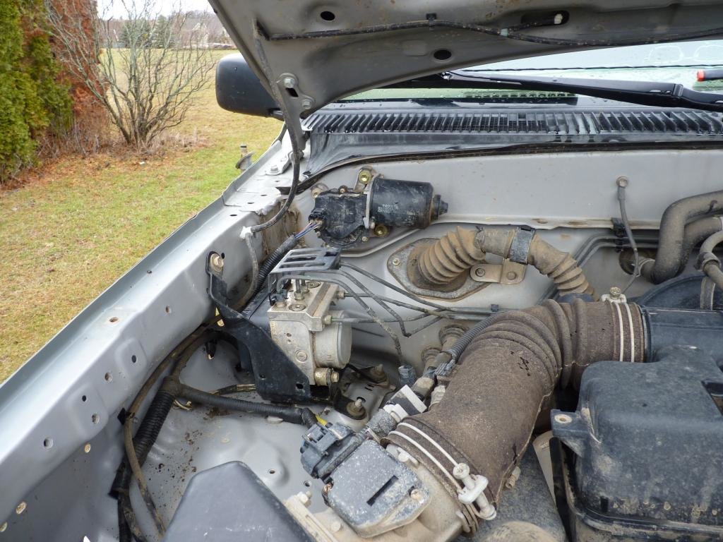

    Right now I think the best location is pretty much straight back from the air box into the firewall. In that location it's easier to get to and there'd be more room in front of the intake opening anyway.
    But there's that pesky ABS doohickey thing in the way. I've already pulled the ABS fuses and the truck feels much safer without it. I'm hoping I can just remove the unit and replace the brake lines with those for a non-ABS equipped Taco. If that's not the only thing I'd need to do/replace to make it function like a normal truck, then please someone correct me if I'm wrong.:eek:

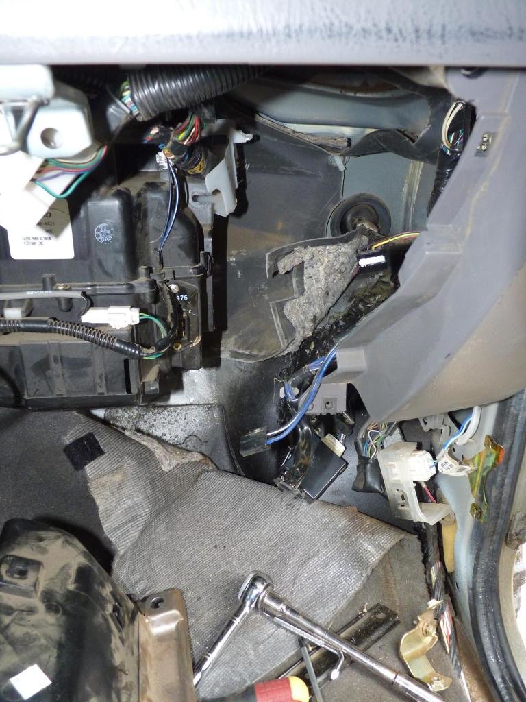

    After a lot of cursing the guy who designed this some of this stuff, I finally removed the blower assembly. I'm pretty sure at one point during the removal I used a tree pruning saw. :anonymous:
    Fuuuuuuucckkkkk
    Wait... a closer look...
    BEHOLD! The unseen area that nobody ever has a picture of! :goingcrazy:
    It seems every time the in cab snorkel mod is done, there's always requests to see the area where the snorkel is supposed to come into the cab.
    I pretty much scrapped the idea of the 'traditional' in cab snorkel, still open to suggestions on how to seal/secure it to the firewall. If there's concern about the firewall being opened up more, I could add a fire proof/retardant wrap? :notsure:

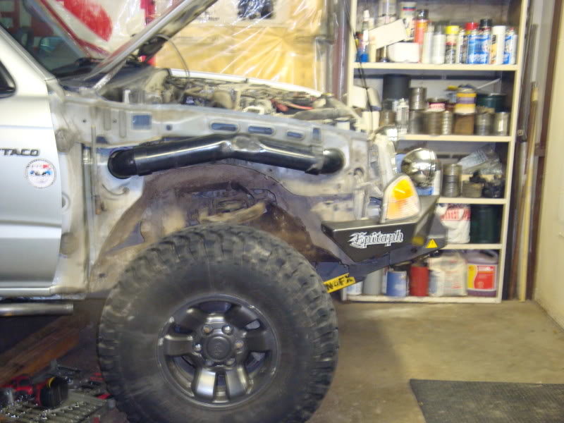

    No there will not be any interference with the snorkel and a SAC. Look at mine.. No where near it being a problem (yet) Maybe with 4D's and ultra clearancing to get 24" of uptravel (SICK UPTRAVEL BRAH) but really, even then IDK if it would be in the way.
    When I redo fenders I am removing my snorkel and need a different place to move it...

    You think so?:confused: I was looking at some linked builds and it seems coilovers/hoops could potentially occupy that area.
    Also I'd like to try and get the axle as far forward as possible and at seems like most guys doing so, end up trimming all the way to the corner lights. The OEM intake seems to take up a large portion of that area.
