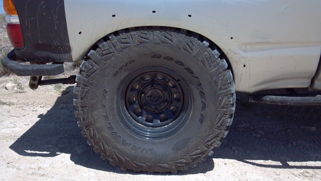

    Nope. Sorry to be the wet blanket but 35's aren't going to fit with your current lift and a 1" body lift unless you tub the firewall and cut fenders. I know for a fact since I have the same amount of lift and the 1" BL and some 35's on hand that have been tested for clearance.
    Go back to pretending because that's the only way it's going to work.

    Perfect pic BR just posted
    And that's with 33"s
    You may be able to fit 35"s but if you expect much (if any) flex, I agree cutting is the best option. Why so against cutting anyway?
