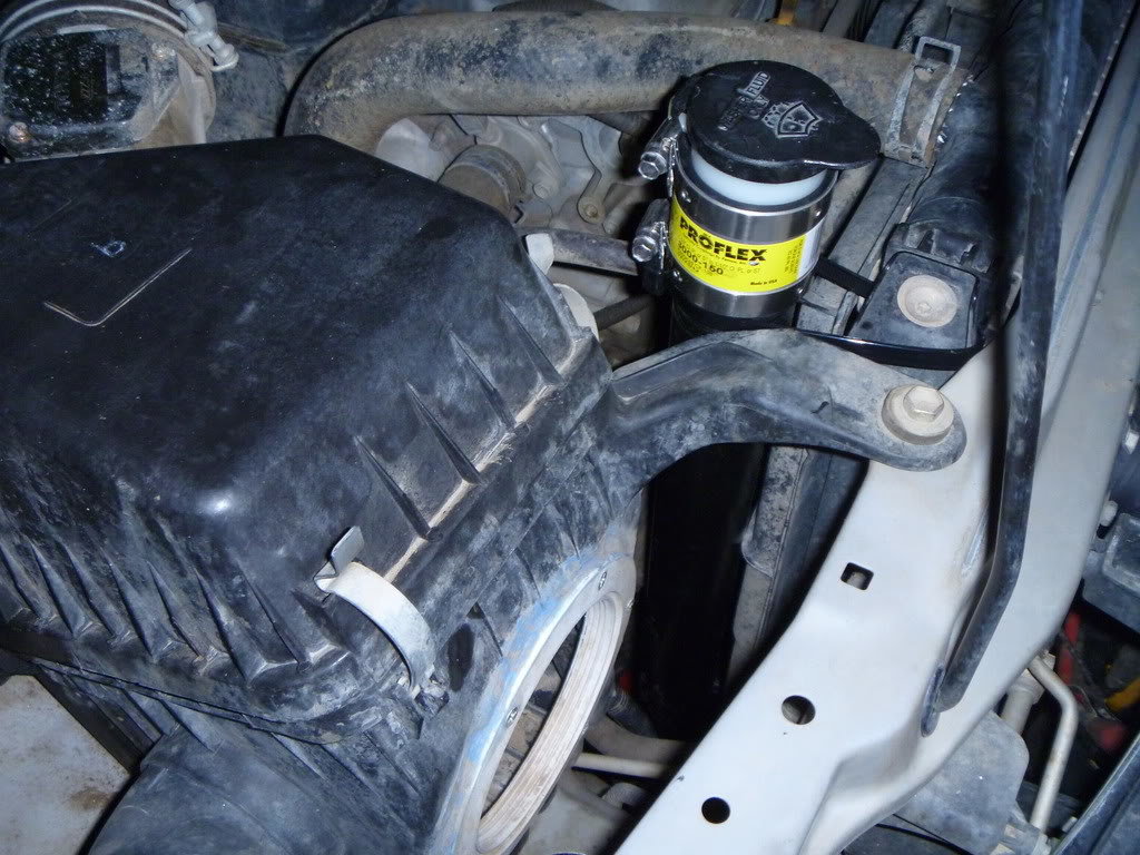

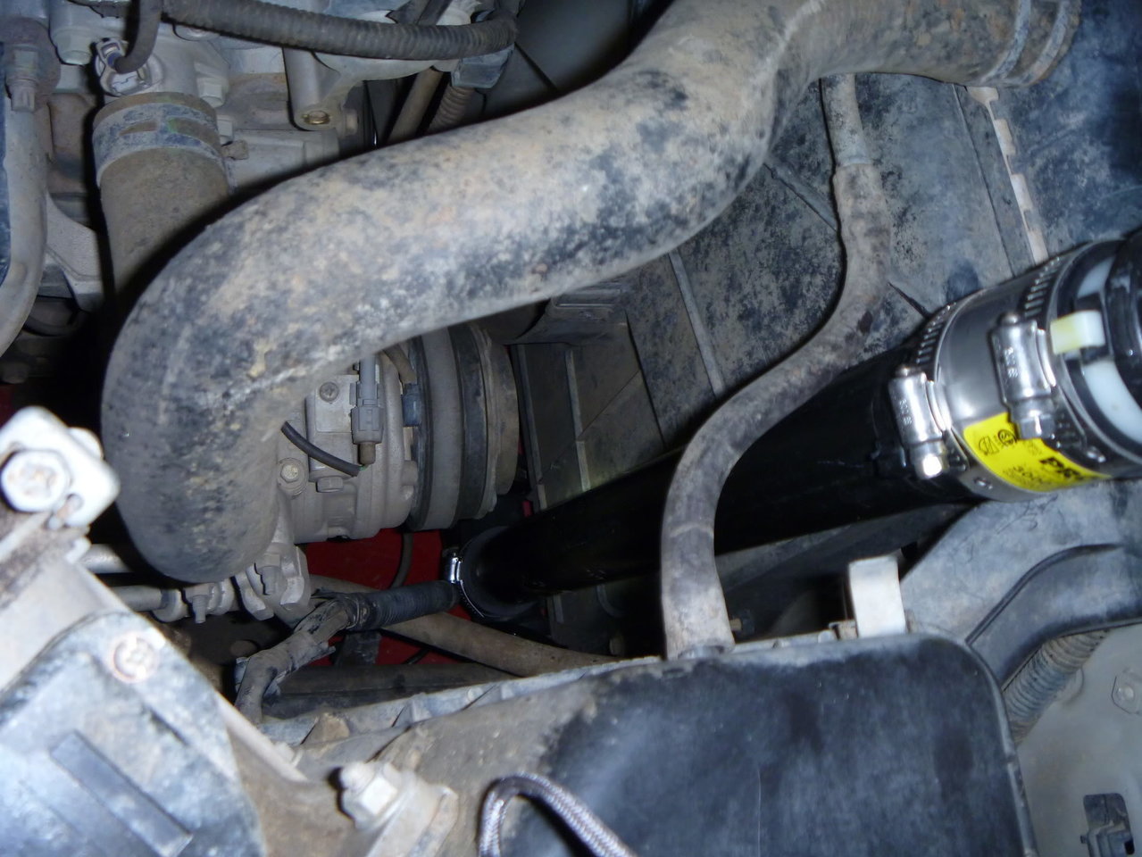

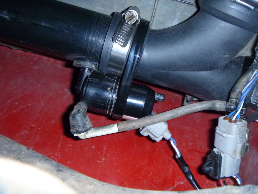

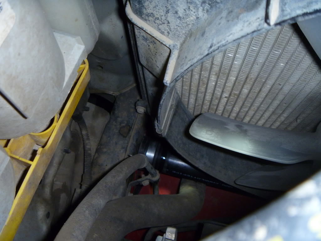

    Got it done, mounted, and working. I ended up just using some HD zip ties and attached it to the radiator frame. Had to relocate the pump to the lower pipe because it was gonna be next to impossible to mount the reservoir with the pump squashed against the frame. In doing so, I added 2" to the overall length of the lower pipe.
    The other end goes underneath the fan and butts up against the frame
    How the pump sits. Apparently all it takes to bypass the low fluid sensor, is to simply cut the wires.

    that is sweet man!
    totally gonna do this!
