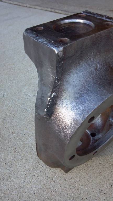

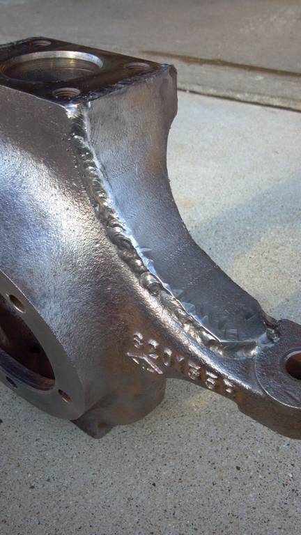

    BTW, I took a page from your build and just finished up welding up some 1/4" plating on one of the knuckles. In the oven now for cooling. Turned out pretty damned good, IMO.

    Nice. You did pre-heat as well, right?

    Yup, to 400.

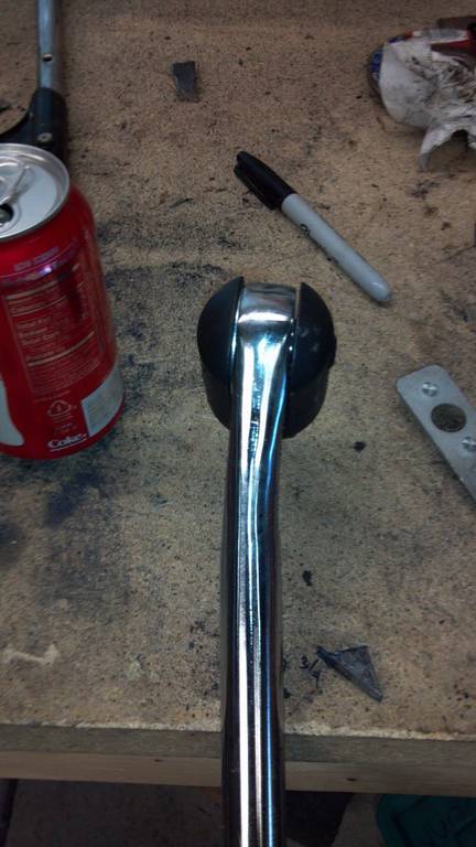

    On another note, how the hell do you remove the stub shafts?? Only thing I could find online mentioned first removing the c-clips from the u joints but all I see is some gaskets/rings, which I removed.

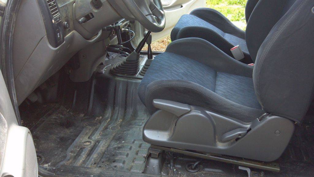

    Not sure I ever posted a pic of the finished bed lined floor. Regrettably I removed the shifter boot cover thing. Now I have no cup holders. I also siliconed the shit out of all the wiring and sensors running along the floor. I'd like to move the airbag computer to a higher spot but I don't know if that'll screw anything up.

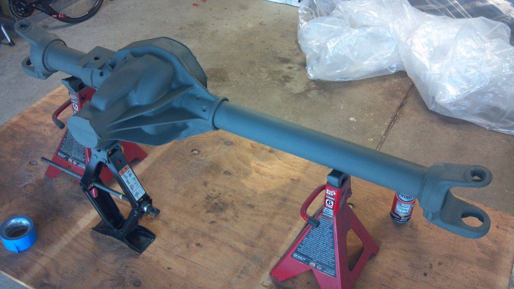

    Cleaned up the housing and broke out the self-etching primer.

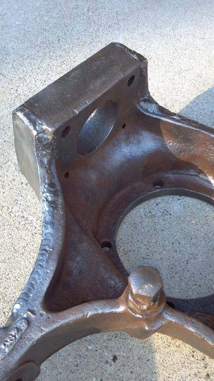

    Now in the process of cleaning up the knuckles and welding the 1/4" plate reinforcements.

    Still gotta grind down the welds, but here it be.

    Your welds sucks :D

    After the c-clips are removed place both sides of one of the yokes across an open vise. Hit other yoke (should be standing vertical) with a bfh to get it to start moving. From there you will be fine.

    yay another to add to the 37" ifs club

    but the knuckles are looking good dude.

    Custom Everything, 1 Ton Axles F & R
    Oh they are there. Mine blended in and were one with the shaft from rusting for 40 years. PITA to remove but they will come out. Look closer lol
