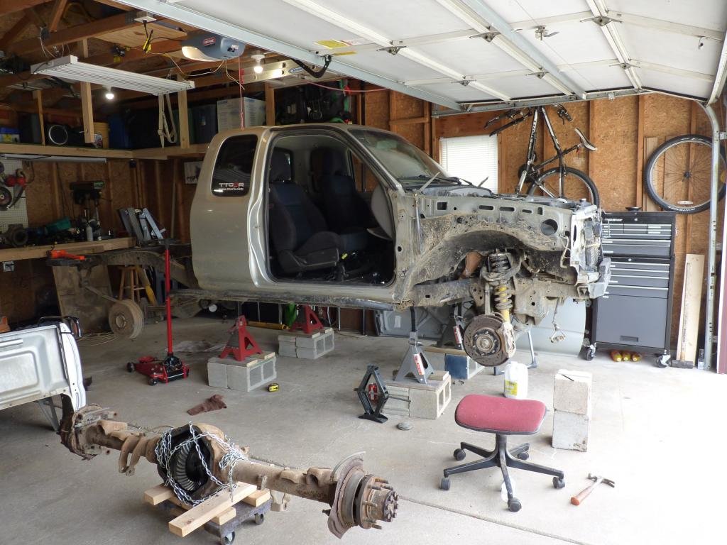

    Yeah I went to HF yesterday to pick up more jack stands and a shop crane. It's already up on stands now and getting everything pulled.

    I'd set the frame height about as high as you can get it since it'll be nicer for working underneath it...! At least 25" frame height (most likely you'll end up around here for ride height)
    Oh and.. POWER WASH THE SHIT out of the underside before you cut...

    Too late :anonymous:
    I think the frame is sitting ~29" (not gonna be ride height!)

    You'll hate yourself for not power washing the underside... I'll be waiting with my :popcorn: to say " I told you so" [​IMG]

    Haha, I already regret it. Luckily it's not as bad as NwiTACO's:D
    BTW, any reason I shouldn't go with electric fans for the radiator?

    Because they can fail and then you have no fans... haha. Mechanical fan FTW!! (yes it can fail too... but not as likely) :D

    And yea I wouldnt do electric fans.

    Also for a safety concern, I would change out the cinder blocks. They really aren't designed for that type of weight on them. They can give way at any time and I wouldn't want that to happen especially if you are under the vehicle... Food for thought.

    Good call. I've had one bust on me and it was pretty scary.

    Yeah, I had thought about that, but I also didn't want to extend the jack stands to the point of being unstable. I figured putting the wood in between the blocks and the stands would help displace the weight and absorb shock/impact.
    Also figured I could tack weld the jack stand arm to the metal base, as well as to the frame for additional stability. :notsure:

    Haven't done any cutting yet. :p

    Also..know it's a bit late for it..but I hope you have plenty of room on the drivers side..
