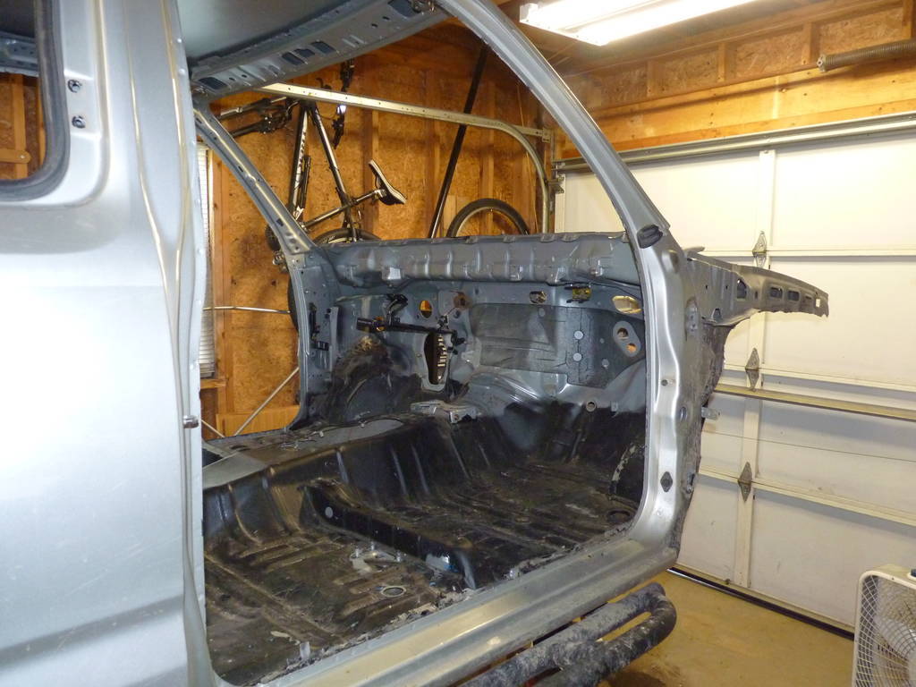

    honestly dont know what the point of gutting the cab and removing the entire harness was. that will just be a bitch to put back together

    And yeah, actually pulling the whole wiring harness is way easier that trying to work on it while it's still in the dash. It's now laid out across the garage floor and I can sort everything out. Should have done that at the start.
    Also gives me room to work on the cage (and yes, not worry about fires :p ) and I'm tossing around a few ideas like ditching the whole heat/AC/blower unit. Possibly mount the brake MC under the dash, maybe the air intake as well. That would give me more room to play with in regards to the engine cage, suspension, and turbo.
    Still stripping things down. Engine is ready to be detached but I CAN'T FIND A SECOND LIFTING POINT. WTF:confused: Probably gonna make the radiator support removable.

    Holy.......shit......Jon. There isn't a truck left!
    Makes sense with the harness but I would never have the patience for that.

    DAMN MAN :eek: we wont see this thing wheeling for a good year or two :p

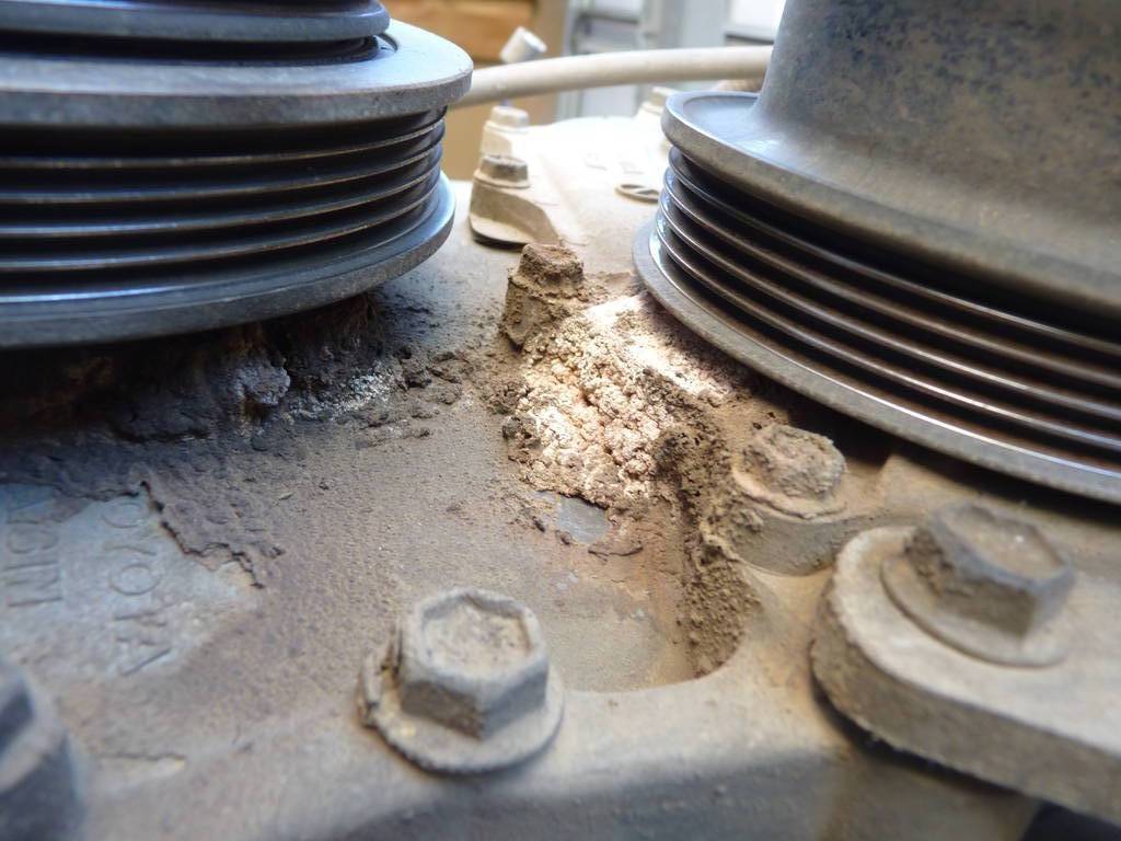

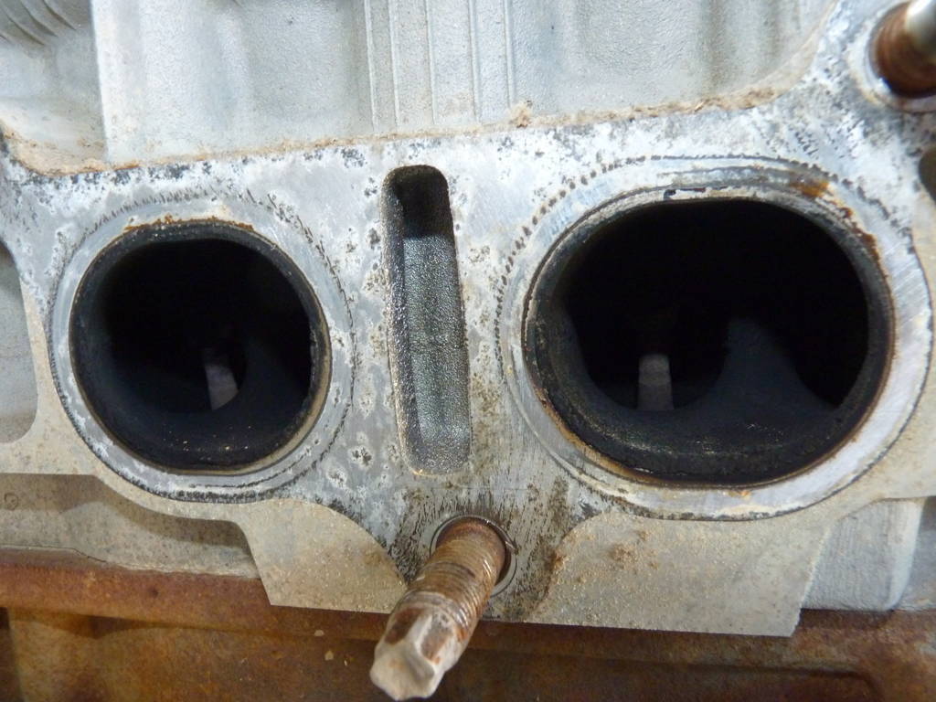

    Wouldn't it inhibit air flow to the turbo?
  13. Aug 10, 2013 at 5:17 PM
    #1173
    Supra TT
    Supra TT Supercharged Lifter
    Jan 3, 2011
    #48645
    7,226
    Eric
    Indiana
    2000 SAS D60 F/R Supercharged
    Supercharged on One Tons
    Just because the turbo is hooked up to the exhaust doesn't mean it forces air into the engine through the exhaust. The exhaust output from your vehicle spins the turbo which on the other side of the turbo is a air compressor that spins with it. The spin from the air comp sends it into your intercooler and then into the engine.
    It may inhibit airflow to the turbo SUPER SUPER SLIGHTLY... but if you are to clean the exhaust portion of the engine, once it starts up again it will be completely dirty.
    I assume the picture is of the exhaust? Because if not then all of this I just said is completely retarded :D
    And if its the air intake manifold, then it would be helpful to clean out the TB and the manifold, but not 100% necessary!

    Thanks for the clarification. This further validates the fact that I don't know shit about trucks haha.:eek:
    FWIW, at first glance the bottom portion looked as if there was ~1/8" of accumulation . Was just a misaligned gasket that made it look that way. :anonymous:
