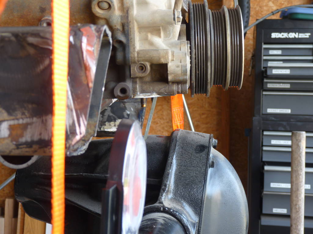

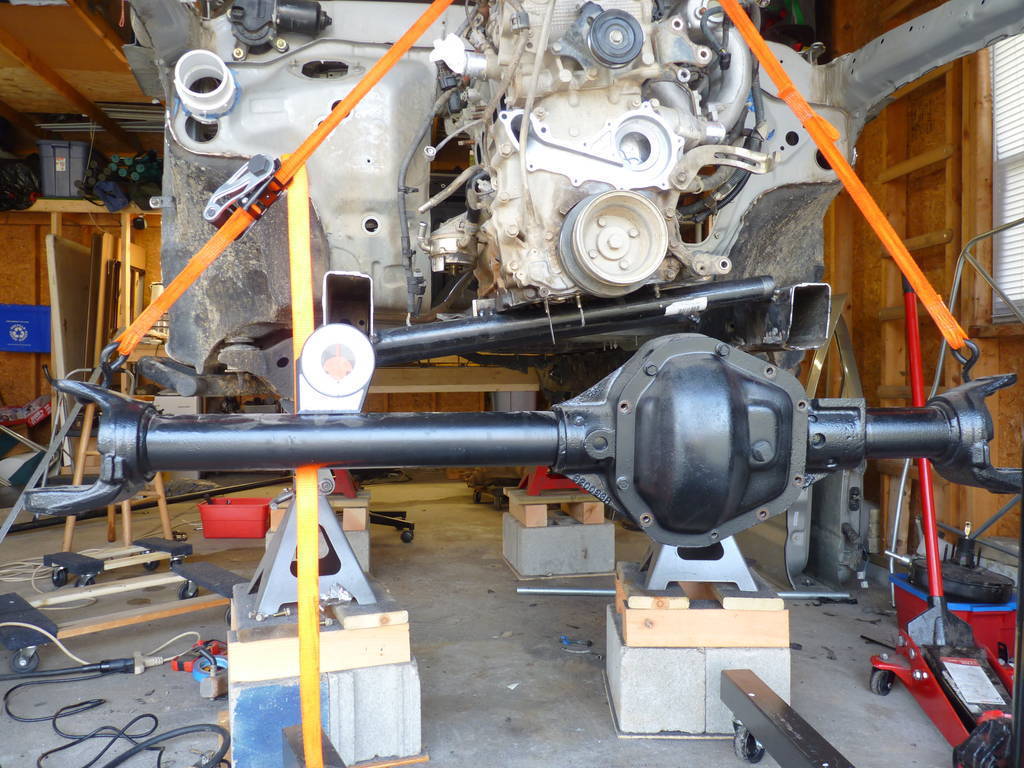

    Yeah baby steps would've been ideal but like I said, plans seem to change constantly during the course of a project so I might as well start cutting now. And there's no way in hell I'm ever giving up or gonna lose interest in this.
    I kinda half listened to your guys' advice the other day. :eek:
    I still wanted a way to access the back of the engine/tranny so a hole would be cut into the firewall anyway. I positioned the engine a little more back than the original firewall would allow, but not so much that I couldn't reinstall the heater/blower.
    The way everything is placed on the 3RZ, it seems next to impossible to leave it all alone and at the same time get the upper link where I want it. Oil filter and motor mount are in the way. Wouldn't have been an issue if I had a passenger drop t-case. Moving the engine slightly back helps a bit, as will modifying the motor mount to clear the link. But if I do that, I have to lose the AC compressor.

    Here's where I'm at right now. Rechecked and it looks like I might be able to keep the AC compressor after all. :eek: I should be able to get a straight panhard in there too.
    Hoping to get the motor mounts done today as well as the front portion of the frame and begin the link crossmember.

    Well since plans change so much anyways...and you said a pass drop tcase would help things...WHY NOT GO THAT ROUTE? In the end the only thing you would lose is the high pinion.
    Your axle is worth bucks, this we know.
    Sell that thing and get a chevy kingpin axle which are a lot cheaper and still just as strong. Some also came with 35 spline stubs stock.
    Go with the pass drop chevy and regular old school gear case setup with duals.
    Simpler driveline, accomplishes your ideal link placement, and puts cash in your pocket which you can put towards the build elsewhere.

    If the driver drop issue wasn't something I could work around, I would go that route. So far it looks like it'll fit.
    Shaving the 60 will be one of the last things on the to-do list, but it's definitely on there.
