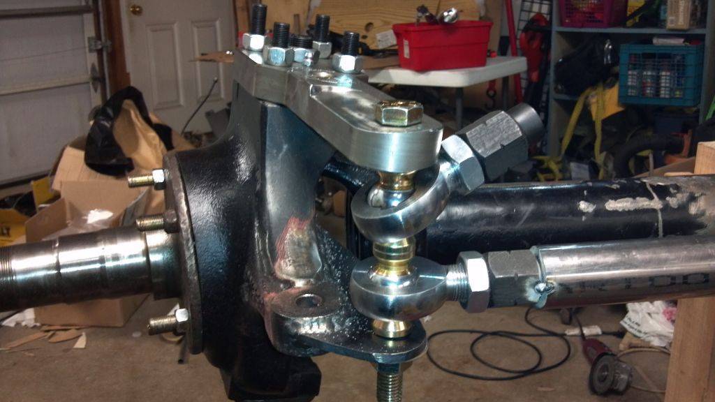

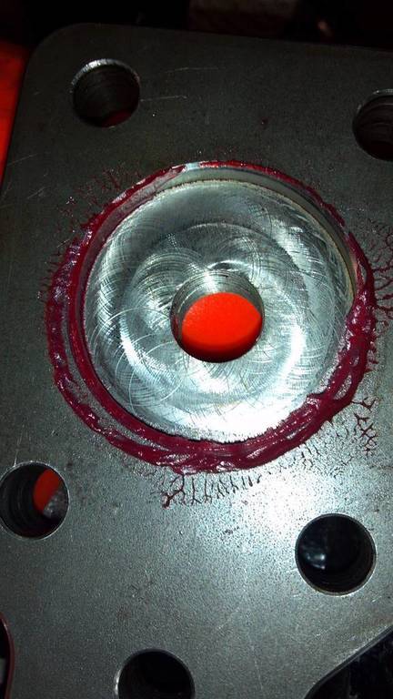

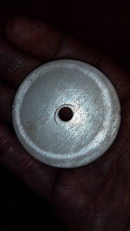

    Been busy though. The 5th set of arms was again F^$@ed up so I tried to modify the plate that sits on top of the kingpin so it will work well enough that I can move on. You can see from the pics just how far off-center the bored out area is.
    Working on the double shear for the knuckles and the panhard bracket now. I cut off the other brackets and I'm starting from scratch as soon as some tabs arrive.
    Also gonna try mounting the steering box at a slight angle to reduce the chance of heim getting maxed out/binding while the passenger side is at full droop.

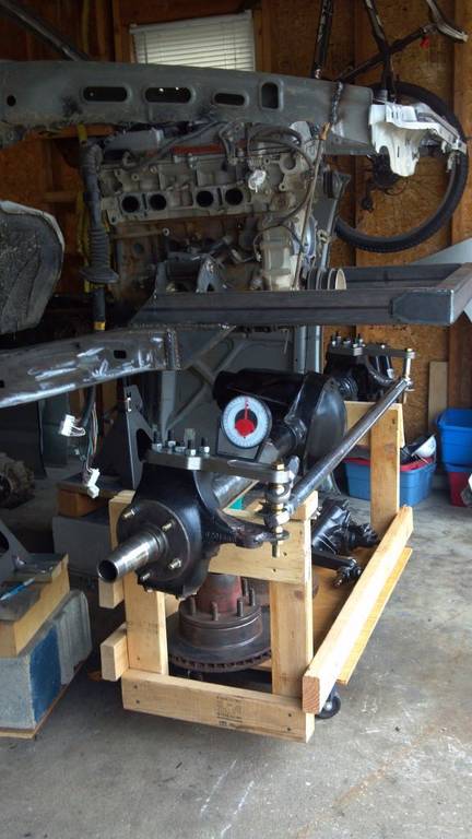

    Made the tie rod/drag link setup with double shear using some 1/4" plate. I may add more plate where it meets the knuckle just because.
    Finally got around to building a rolling cart for the 60 at ride height.
    Waiting for some tabs to arrive so I can rebuild the link brackets and figure out where exactly I want the steering box and panhard.

    Definitely reinforce that double shear plate at the knuckle. 1/4" is kinda thin. I laminated and plug welded two pieces of 3/16" together for mine.
    That cart is a good idea. It looks like you have an angle finder on the axle to "set" caster...just FYI these axles (1978-79 Ford D60) like about 7° at ride height, but knuckles lean back not forward like yours is sitting.
  20. Oct 17, 2013 at 6:16 AM
    #1260
    45acp
    45acp [OP] Paint me back in Wyoming again...
    Aug 9, 2009
    #20861
    6,705
    Jonathan
    Boring, Wisconsin
    1981 Long bed 4x4
    Thought it was positive caster that they run with? Or is that just dodge/chevy axles?
    I was trying to get the pinion pointed at the tcase unless that only matters with the rear axle.
