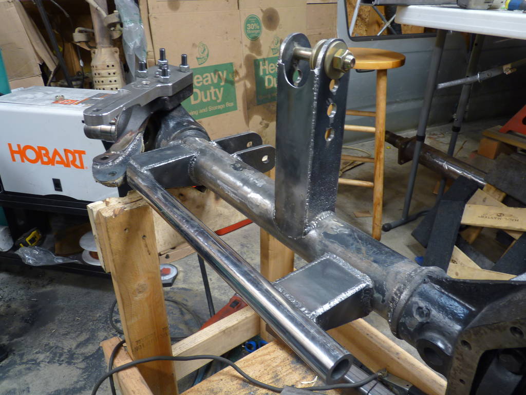

    Got some welding done on the front today. Beefed up the double shear so it's 1/2" now. I had some extra 1.5" x .5" wall DOM laying around So I built the platform thingababobber that the panhard and hydro assist will mount to. I would have bent some tube instead of using 1/4" plate but SOMEONE is borrowing my JD2

    Looks good as usual. Upper link mount looks really tall but I know you are gonna dial it in and prolly trim off the rest. Only suggestion would be to gusset that bad boy if you end up using one of the upper holes.

    Would hurt to add a gusset to that tower. Looks good though.

    I have the tower completely boxed in on the other side below the braket holes, but will do on the gussets. Can't hurt haha.
    I guess it looks tall but the highest position is at 10" from the axle center and clears the engine and engine mounts with room to spare.
