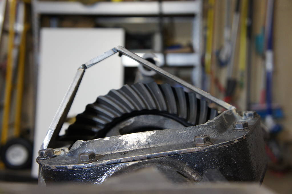

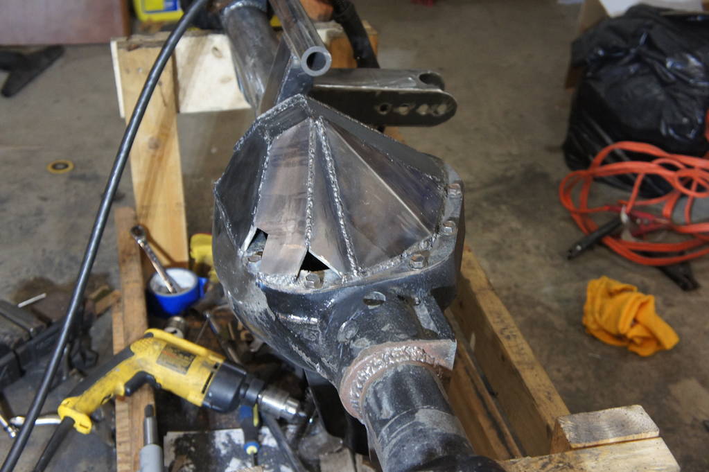

    Progress has been slow (big surprise :rolleyes:) but I shaved the 60 and got the diff cover roughed in (out?).
    Diff has about 1 1/4" of extra clearance now.
    I shaped the diff cover the way I did for a few reasons. Bottom section will be beefy as f&^# to take hits, slope gradually to slide over rocks a little easier, provide some protection to the bolts, and to add oil volume. Top section sits close to the ring gear to clear the panhard at full bump.

    Sweet!! Going to be an an insane cover, man. lol I wonder if it would be a good idea (or just overkill) to add a gusset on the inside of the cover since there is obviously room... holes in the gusset wouldn't affect gear oil flow adversely, I think. Just thinking the extra gusset would be nice if you happen to land on a rock with the end of that cover. since it is longer than a traditional cover, it won't glance off quite as well, I think, and apply more force to the studs.... :notsure:

    Yeah, gussets were part of the plan. Didn't think of adding holes though. If the gussets impede oil flow, that should help. Thanks bud :cool:
    Haven't decided on a fill plug, or a location for that matter. Would be nice to have a large one for inspecting the ring gear. Any suggestions? Gotta keep the top flat though, so it'll clear the panhard.
