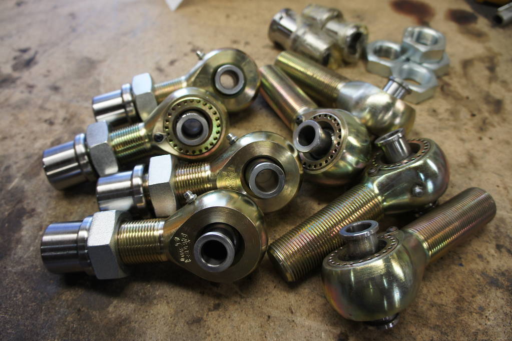

    Anyhoo speaking of other purchases, the rest of my Enudro joints and rod ends arrived today.

    pretty parts :drool: also..buy the locker..what credit cards are for right? lol

    Are you using endure joints for steering components too?
  15. Dec 5, 2013 at 1:22 PM
    #1515
    45acp
    45acp [OP] Paint me back in Wyoming again...
    Aug 9, 2009
    #20861
    6,705
    Jonathan
    Boring, Wisconsin
    1981 Long bed 4x4
    I'm running 7/8s RuffStuff heims for steering and upper links.

    That's the same thing I did. It just looked like a lot of rod ends and I didn't know how many you had before.
